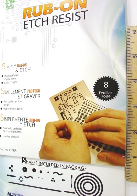

Re: Creating PCB's
« Reply #5 on: December 26, 2021, 06:24:24 PM »
There used to be dry transfer resist that worked just like dry transfer lettering but that disappeared years ago.

The venerable etch resist pen is still available.
Re: Creating PCB's
« Reply #12 on: December 27, 2021, 05:37:36 AM »
You can still purchase the etch resist rub transfer patterns.
