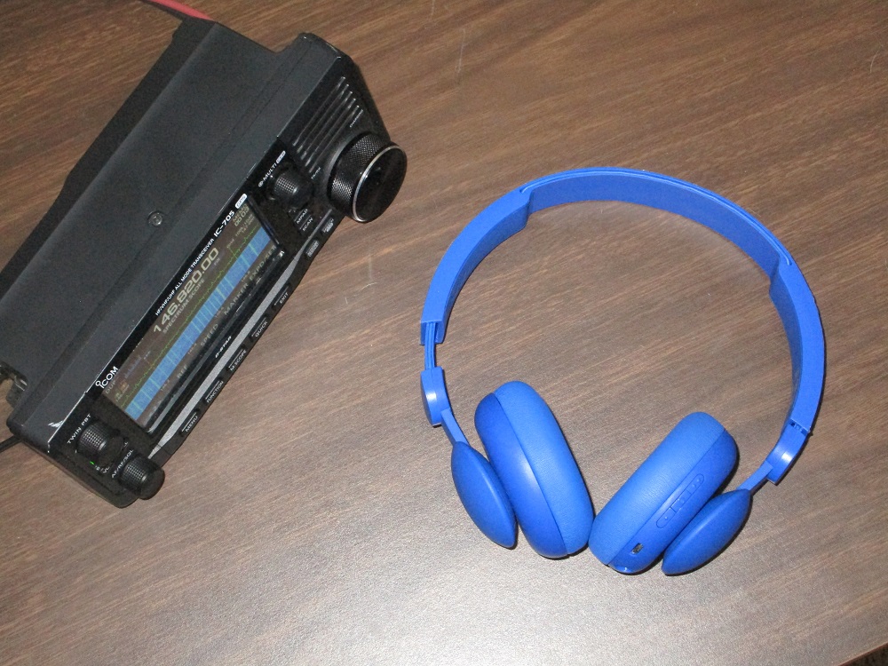

Bluetooth headsets
Fortunately, the 705 will pair with my $15 bluetooth, cellphone headset not just their rather expensive VS-3 headset. I have to turn the VOX gain up pretty high. It does not have PTT but I found that by turning off the +8V microphone jack output, then plugging the CW key into the microphone jack, the key can be used for PTT.
https://www.walmart.com/ip/onn-Bluetooth-On-Ear-Headphones-Blue/106145703
