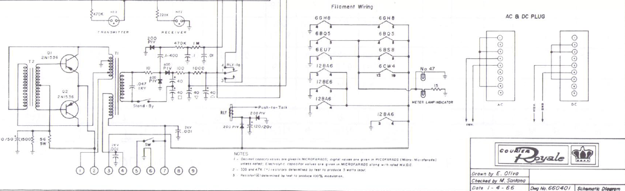

So I have a courier Royale 23 CB. It seems like it would be nice to conver to 10M with a synthesizer at some point. I just wanted to do basic functikn checking first however. I went to power it up and am getting nothing except a pilot light on the front. Not even filaments. The transformer is getting hot but nothing else is. I am seeing no HV on the diodes. I think the primary is burnt up, I may have accidentally done it trying to run the unit on a 12v cable. Any thoughts on how far up a creek I am? If worse comes to worse this seems like a gold mine of parts including a Collins 455khz mechanical filter.

Re: courier royale cb transformer burnt up?
« Reply #3 on: January 19, 2022, 08:44:57 AM »
Make certain that the plug is wired correctly for 120 VAC operation and not for 12 VDC. Here is the power supply area including the correct plug wiring:
A continuity check between pins 4 and 5 will tell you if the 120 VAC primary of the transformer is intact. If the plug isn't jumpered as shown, you won't have the filaments connected for 120 VAC operation.

« Reply #4 on: January 25, 2022, 10:07:09 AM »
The 120VAC cord was from another Courier CB and wired correctly. I checked the 12VDC cord and it was wired correctly as well.
I measured the primary resistance of both transformers, the suspect one is less than half of the other (10 vs 20 ohms approximately) which seems really fishy. I haven't gotten to disconnecting wiring yet but I think that's the next step. I suspect this is coming out regardless. I will say that if I can get a transformer I'll probably try to get this running again. It's actually a high end unit (I suspect as CBs come anyways) and I think it would be interesting to see what it does on 10 AM. It's got a Nuvistor preamp and Collins Filter unit as well, so I suspect it wasn't a cheapie when it was made.
