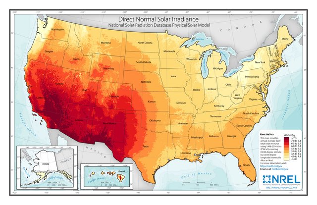

It is time to start thinking in terms of energy (typically kw-hr in the US) instead of power. You need to consider how much energy your panel will generate on the average day. It will be less on rainy or partly cloudy days and it could be more on a sunny day. If you panel has 3 perfectly sunny hours in a particular day, you may generate 1.2 kw-hr (400 watts * 3 hours) but you will store less due to the inefficiency of the charge controller and the battery.
To calculate the average annual energy generation, you start with a map to show you the average solar irradiance for your area. You can then use this to calculate your overall infrastructure requirements. Monthly versions should then be checked to make sure it will meet your needs in winter when there is less solar irradiance:
Sengupta, M., Y. Xie, A. Lopez, A. Habte, G. Maclaurin, and J. Shelby. 2018. "The National Solar Radiation Data Base (NSRDB)."
Renewable and Sustainable Energy Reviews  89 (June): 51-60.

Just to give you a starting point, let's calculate the energy that your panels might produce annually assuming you are using them near your home QTH. The average annual solar irradiation for that area will produce 4-5 kWhr/day per kW of panel. Your panels will produce 0.4 kW when illuminated with 1000 watts of solar power. Using conservative numbers:
     0.4 kW * 4 kWhr/day/kW of panel = 1.6 kWhr per day (annual average)
In the worst sun day in December and by titling the panels toward the lower sun, the solar production drops to 2 to 3 kWhr/day:
     0.4 kW * 2 kWhr/day/kW of panel = 0.7 kWhr per day (worst case sunny day)
Since the MPPT converter is not 100% efficient, multiply the above by 90% to the maximum energy available. So annually, your system could produce:
     1.6 kWhr/day * 365 days * 90% = 525 kWhr annually
That sets the absolute limit that your system will produce - the annual energy consumption of all of your loads cannot exceed this number. But as Mark and others have point out, you now need to consider the short term effects due to cloudy days, peak loads, etc.
Just to put these numbers in perspective, a small 4.8 cu ft, energy efficient refrigerator consumes over 200 kWhr annually. That is nearly 40% of the total energy generated by the solar panels without accounting for inverter inefficiency. So on an annual average basis, this should work. Keep in mind, however, that your daily energy production in December drops to less than half of the annual daily average. And if you had to keep the refrigerator running for a cloudy week with little or no solar energy generation, you then need to look at your battery and inverter system to determine if it could supply all of the needed energy.
