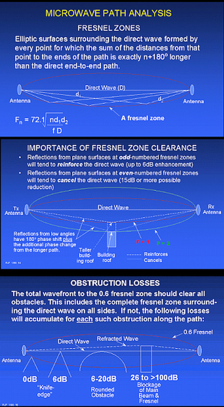

« Reply #18 on: June 07, 2022, 02:38:16 AM »
Below are images from a set of PPT slides showing possibly more important elements than antenna height and feedline length in the performance of point-point terrestrial links at VHF and above.

RFRY,
One factor not covered and often significant is trees.  They are obstructions,
scatterers, and attenuators depending on height and frequency..  At VHF
maybe an amalgam of all three.
However often the signal gets through despite all that.
