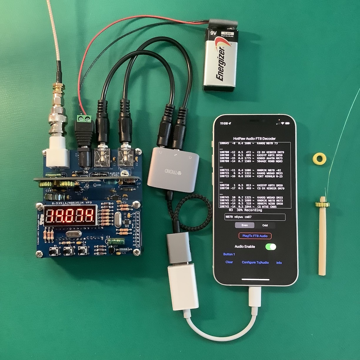

A Heathkit HW-9 weighs 4.6 lbs.
The QRPGuys Digital Mode FSK transceiver III kit weighs 87 gram, assembled for 1 band, a bit lighter than 4+ lbs.  https://qrpguys.com/qrpguys-digital-fsk-transceiver-iii  But it requires a small amount of SMT soldering, so not a starter kit for complete beginners.
But, if I couldn't build, instead of just waiting for and buying a pre-built appliance radio, I would hire an experienced kit builder to build a new kit for me, and maybe even have the builder let me do small parts of the assembly myself so I could start learning how the radio is constructed and works.
« Last Edit: May 11, 2022, 11:21:37 PM by N6YWU »
That QRP guys kit looks like a great option for the homebrewer.  I wonder how light a complete digital station can be, including batteries, computer, visual display, and antenna?
N6YWU
  • Posts: 362
Minus the antenna, here you go:
The digital transceiver is 87 grams, computer+display is an iPhone 13 mini at 135 grams, didn't weigh the cables and adapters.  The 9V alkaline is 45 grams; but you may want to use a larger (heavier) battery to Tx at the full 5 Watts.
An iPhone 13 has more DSP peak computational performance than most PC laptops.
