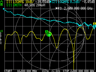

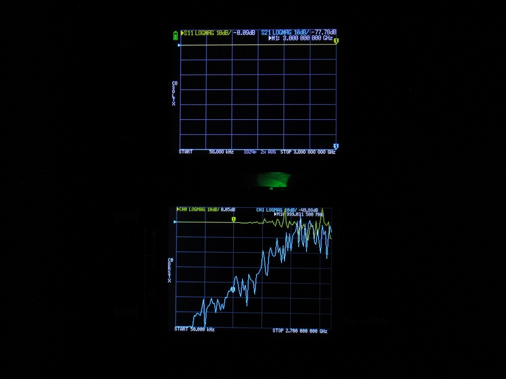

Below is a direct comparison of both. The nanoVNA with firmware allowing up to 2.7 GHz while the LiteVNA is set for 3 GHz.
The isolation ( S21 ) is much better in the LiteVNA which is set to 1024 points with 2 averages.
This is screen capture from the LiteVNA

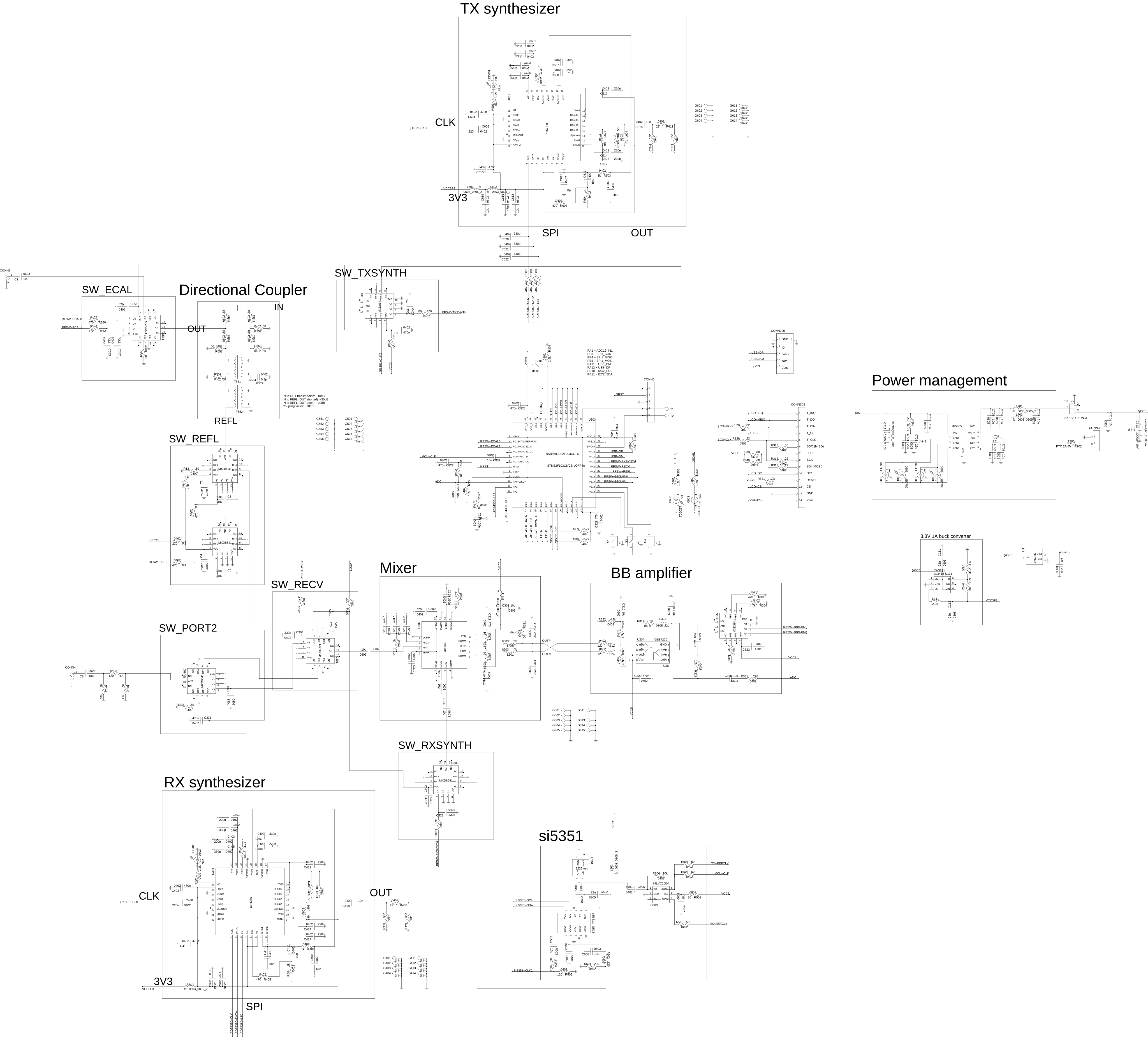

I would need to see schematics of both to judge if it is a clone or not.
Here is the schematic for the V2 ( SAA2 )

I tried to verify if the LiteVNA is a clone of the OwOcomm V2, but it is not easy.
The schematic above, is of the OwOcomm V2.2 which is an early version spec'd to 3 GHz no longer sold. A check of the parts used like the MXD8641 switches indicate those parts are specified to 2.7 GHz so they are stretching it a bit. I suspect the directional coupler is designed to work to 3 GHz but probably not much more.
However,
Quote from: nanorfe
V2.3 and V2.4 designs are confidential and proprietary, and reverse engineering is forbidden.
It's not entirely clear if the V2.3 and V2.4 are the V2 plus 4 and the V2 plus 4 pro, but assuming they are, then the switches and coupler must be different to allow them to work to 4.4 GHz. The ADF4350 synthesizer chip from Analog Devices in all versions works to 4.4 GHz.
Since the LiteVNA is spec'd to work to 6.3 GHz, it seems unlikely that its coupler and switches could be the same as in the 4.4 GHz OwOcomm models. If the parts are the same, then it would be a clone, if LiteVNA re-designed it with different parts to reach the higher frequency, then probably not.

It looks like the LiteVNA is not a clone.
Both the LiteVNA and the OwOcomm V2 SAA2 have been the subject of the tear downs below complete with video.
http://www.kerrywong.com/2022/03/22/teardown-of-a-litevna-vector-network-analyzer/
http://www.kerrywong.com/2022/04/03/nanovna-saa-2n-teardown-pictures/
The LiteVNA uses the Maxim 2871E 23.5-6000 MHz synthesizer. The Owcomm uses the Analog Device ADF4350 137.7- 4400 MHz synthesizer which explains the different frequency range. Both are direct mixing to their maximum frequencies which is good news for buyers of either unit.

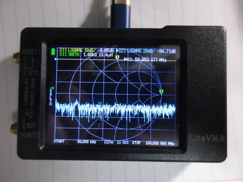

At 5:41 minutes into the video it is mentioned that the LiteVNA's with a noise problem have a noise floor of -60 dB when connected to USB; that the ones without the problem measure closer to -80 dB while measuring to 100 MHz.
I have the 2.8" version with the same firmware v1.2 with a build date of Feb 28, 2022 only a few days after the build date of Feb 25, 2022 for the larger version in the video. The hardware version shows as 63-0.3.
This is the noise floor I see connected to USB,
Since the noise problem seems related to the USB voltage, it may be that I am just lucky this computers USB voltage is just what is required to not create the problem.

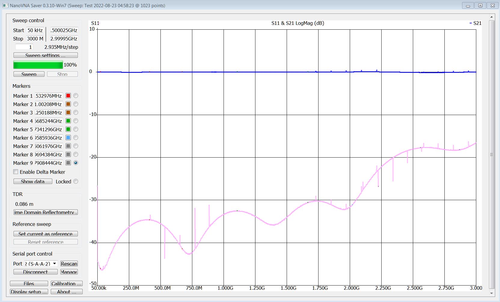

In regards to the nanovna saver software, I was a bit disappointed that it no longer runs under Windows 7. There is a unofficial version that has been made available for Windows 7 and 8 at this link.
https://groups.io/g/nanovna-users/topic/nanovna_saver_for_windows_7/89837731?20,0,0,0::recentpostdate/sticky,,,20,2,0,89837731,previd%3D1648224912725969150,nextid%3D1647626643808954541&previd=1648224912725969150&nextid=1647626643808954541
This is a test of a semi-rigid cable after calibration with the above software.

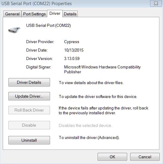

One is to make sure that the correct USB driver is installed in the computer. In my Windows 7 computer, that did not happen. If the LiteVNA is attached to a USB connector what shows up in Windows Device Manager is shown below. Clicking on CDC-ACM Demo shows no drivers installed.
I installed the Cypress driver from this link,
https://nanorfe.com/downloads/NanoVNA-QT/CypressDriverInstaller_1.exe
Then instead of the “Other devices” appearing in Device Manager, a new USB Serial Port ( COM22) appeared under “Ports ( COM & LPT ).
Examining that port we find,

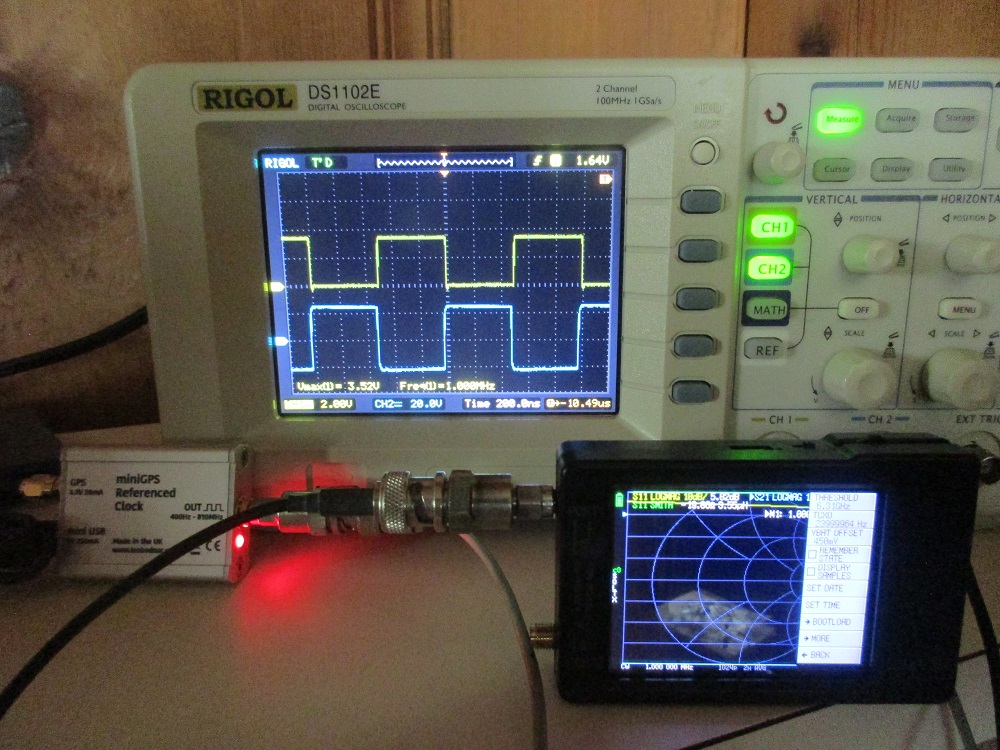

There is no way to calibrate the clock in the old nanoVNA. Today I used a Leo Bodnar GPSDO set to 1 MHz to calibrate the LiteVNA TCXO. The digital scope shows the GPSDO output in yellow, the LiteVNA CW output in blue. A stop watch measured the time it took for the LiteVNA to slip one cycle was 95 seconds which is about .01 Hz error at 1 MHz after calibration.

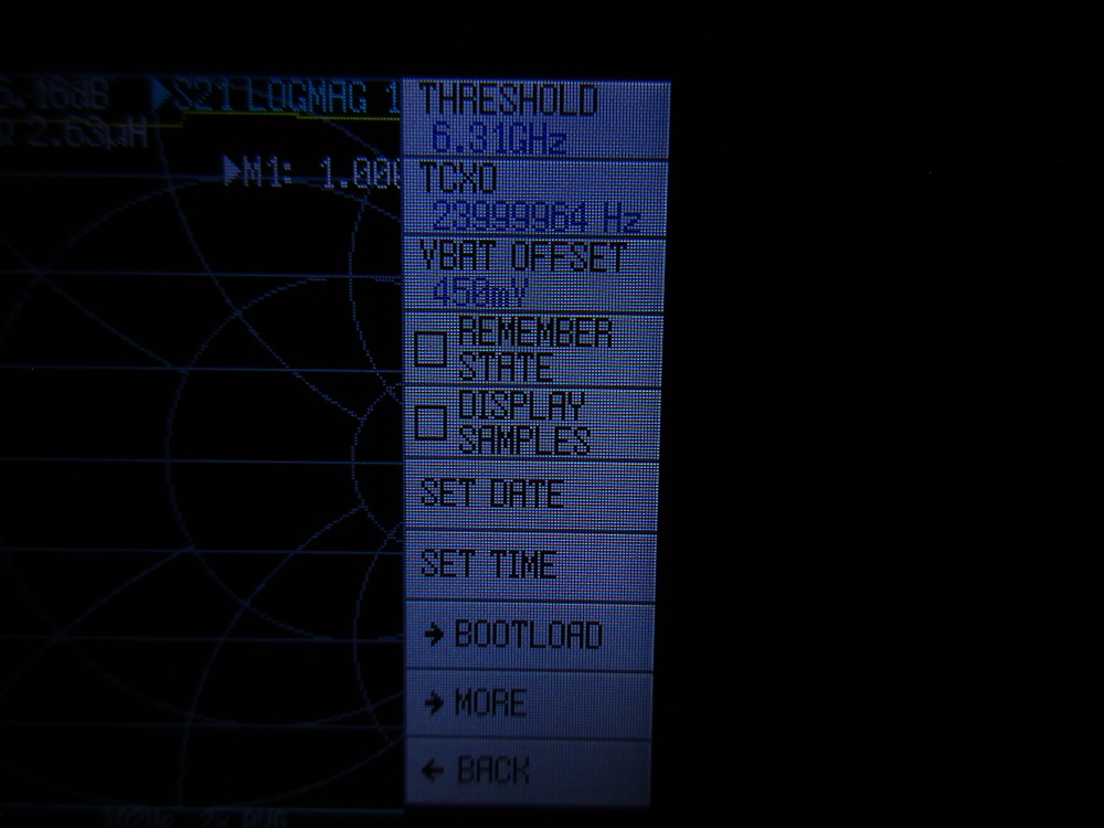

The menu to adjust the TCXO frequency is under the “Expert Settings” as shown below. Just tap the TCXO key to open a window to enter the new TCXO frequency. As can be seen below, setting the TCXO from it’s nominal 24 MHz to 23.999964 MHz provides about a .01 Hz error at 1 MHz.

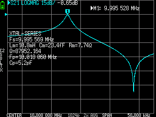

I had some unknown crystals to test. This is the first time I tried this feature. It is fully automated. The display is shown just as it appeared. The LiteVNA located the peak and calculated all the crystal parameters by itself.
