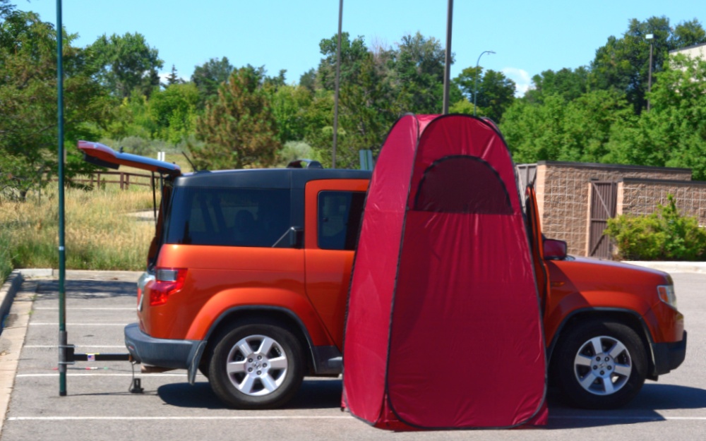

My wife and I sometimes operate for 4 or 5 hours.  Use a 40AH LiFePO4 battery, 100w SSB (or me on CW), and we carry our own "porta-potty".  It usually gets to be dinner time and the dogs get hungry.
When I go to parks on Wednesdays for CW I stay for 3 hours, calling CQ the whole time, also 100w.  The battery is never the issue.

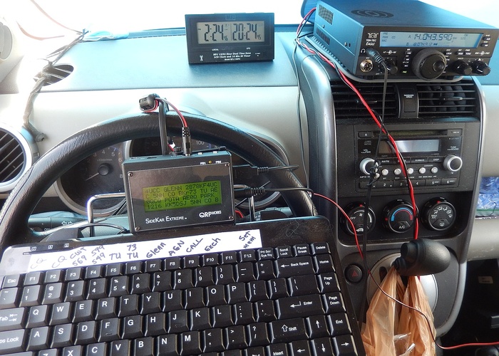

Sounds like it will be a good POTA / WWFF radio!!  I use a TT Eagle (100w) with built-in tuner and 600Hz roofing filter.  Typical activation is on 20m using a 32 ft 20m EFHW on 32 ft mast, but the Eagle tuner tunes it on 17m, too, so I try that band first every time I go out.  Usually make over 100 contacts on CW.
I use a QRPworks SideKar Extreme for CW and logging, it is smaller than a laptop and can be positioned  so my wife can see who I am logging when we operate SSB together.

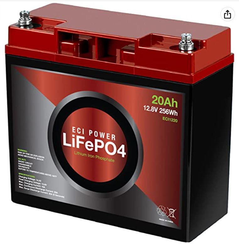

I have been running this one on the Ft891 with good results. $100. About half the price of the bioenno. and has all the same features.
https://www.amazon.com/ECI-Power-Rechargeable-2000-5000-Applications/dp/B0973LL679/ref=sr_1_6?crid=1065TGPQIAOTQ&keywords=20+amp+hour+lithium+battery&qid=1661293707&sprefix=20+amp+hour%2Caps%2C3684&sr=8-6
I also use this battery when operating portable. I use a FT-450D, FT-891, or a Xiegu G-90 at 5 - 10 watts. Have yet to have to stop because of the battery.
