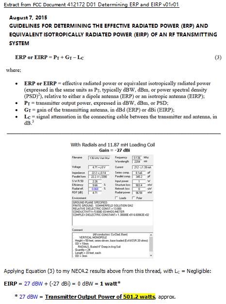

The text in the graphic below is an example of calculating EIRP using FCC methodology, based on a NEC antenna software calculation of antenna system gain in dBi.
