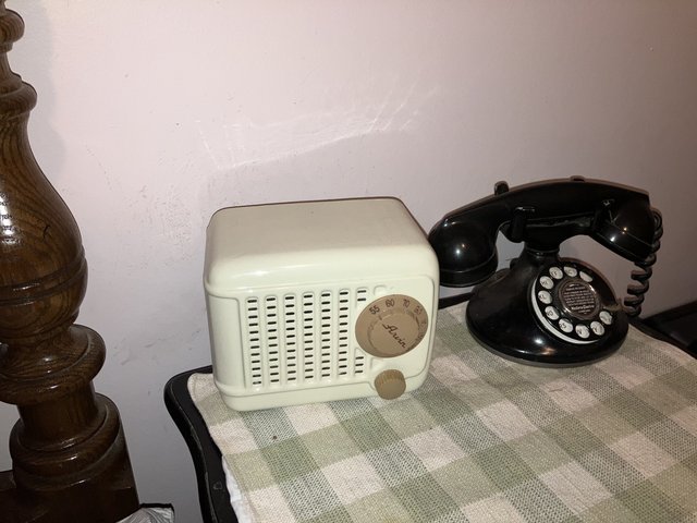

I don't know the little radio but if it is AC powered  and with the tube heaters all wired in series and power plug polarity sensitive, it can make the chassis hot.
If the antenna input has one side grounded and there is leakage from the AC service ground at the pole or elsewhere, a hum will be the result.
The radio could still be plugged in reversed even though the hum is gone.

thanks I will check the polarization make sure the chassis is neutral. This is an Arvin Midget Radio 242T IIRC. I had my friend restore it electrically and I painted it with a hard antique white enamel. It sits next to the bed and I wanted to wake up to local AM by reaching over and turning it on (we have a great local station). Until this happened, that wasnt an option most of the time. Now it is.

Yes, I believe that radio is not isolated from AC and only depends on the plug polarity.
Said another way, the chassis is the ground side of the power feed.
So you can see why plug polarity is important and why the cabinet and knobs are all plastic.

In case you are not familiar with the wiring of an "All American 5" radio, here is an excellent article about the safety concerns.

I think this image belongs on the cover of ARRL Handbook as it represents ham radio perfectly.
KB1SNJ
  • Posts: 163
Re: 60HZ Antenna filter?
« Reply #21 on: February 12, 2023, 08:40:48 AM »
Thank you!    Took many years to roll my house back to the 40s lol
That Bell Western Electric 202 phone actually works. The subset (subscriber set) is below. There's a 302 phone in the living room. They are hardwired to a xlink which is bluetoothed to an old cell phone I keep in a drawer. The xlink produces the dial tone, and the 90vac 20hz for the ringer, etc. It even goes to fast busy if u leave it off hook just like the Bells system did. We actually use them occasionally.
