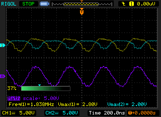

There is one technology that has been grinding forward mostly driven by demand from the defense industry. The number of devices to build an amplifier at a given output power continues to decline. At the 1.2 kW class, the Mercury IIIS is down to a single device. The older MFJ Ameritron ALS-1306 uses eight devices grouped as four matched pairs.
The Mercury IIIS device is actually two devices in one package, but likely matched from the same wafer. Before these type of devices, individually packaged devices had to be hand selected for match.
My study of the 2KL amplifier shows that even hand matched devices are far from ideal. I suspect that wafer matched devices are likely better for distortion. The Icom 7100, 7300, and 7610 all use versions of these single devices.
The gain difference at the collectors ( blue and yellow traces ) is pretty obvious with the above matched devices.
With tube rigs, its not as easy to measure a lower power as with solid state. Did you even see what the IMD was like with the 32S3 if the output power was lower?
