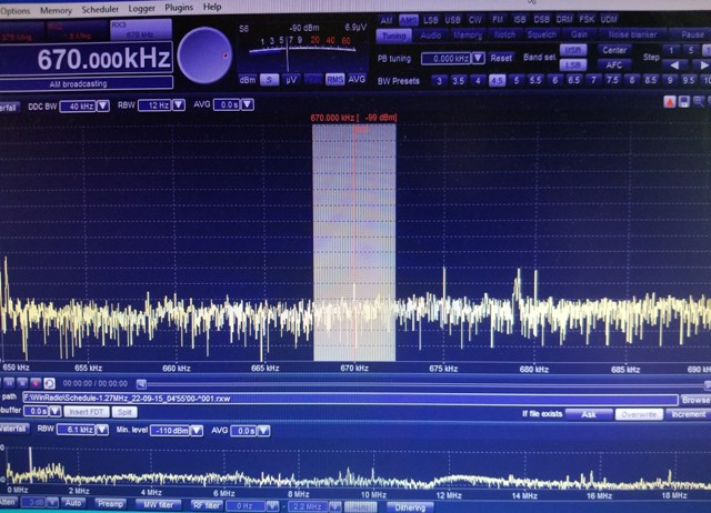

I finally found and resolved an interference problem causing QRM from LW, MW and into SW.
First noticed several months ago when I heard terrible noise wiping out from around 660 kHz to around 695 kHz.
Here is a screenshot of the noise.
https://misc.kg4lac.com/2022-MW-QRM-Example.jpg

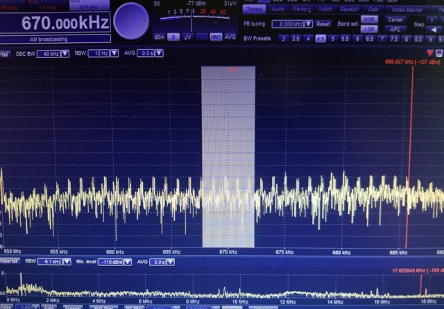

I was determined to find the cause of the interference. I turned off all house power except for the circuit including my radio room. Checked 670 kHz. All noise/interference is gone. This is good as I’m able to continue. Here is a screenshot.
https://misc.kg4lac.com/2022-MW-QRM-Gone.jpg
Turned on the electrical circuits, one-by-one, until the problem returned. Then turned off the circuit causing the problem and continued turning on the remaining circuits to determine if I had more than 1 cause of QRM. Luckily, no, only 1 circuit was the cause.

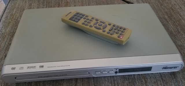

On the problem circuit is a power strip, a FIOs box, a TV and a DVD player. Initially thought it was either the power stirp or the FIOs power cord brick. No, both are OK. Plug in the TV. Still OK. Plug in the DVD player. Terrible noise returned! The DVD player is a Memorex. It’s at least 20 years old. Here is a picture of the problem.
https://misc.kg4lac.com/2022-QRM-Cause.jpg
Now, no more interference and it’s a happy day!

Did you narrow it down to see if it is the DVD player itself or the power supply for the DVD player or a combination of both items?
KG4LAC
  • Posts: 76
Re: QRM Noise on LW, MW and SW -- SOLVED!
« Reply #5 on: September 23, 2022, 02:04:39 PM »
I was so overjoyed with finding the source I haven't touched the DVD player since Thursday. Perhaps, I'll look into the cause, but for now, I'll simply leave the DVD player alone.

probably bad capacitors!
