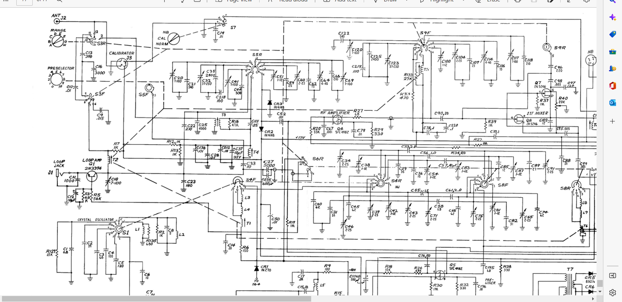

The receiver is a Drake SPR-4 which is a solid state older receiver.
I have lots of test equipment and service ham gear on a regular basis. It is a strange problem that sounds very simple and I mistakenly thought it would be an easy fix. I believe I have covered the simple possibilities already. Other receivers work fine with the same connection etc.
Access to make measurements is very difficult in the front end stages of this receiver so I thought I might get lucky and find someone that had a similar experience. I am thinking there is a possibility of a shorted cap in a tuned transformer in the front end or something similar. The receiver has circuit boards in the bottom of the chassis mounted vertically and in the case of the input circuits they are mounted so close together I can't safely get a probe in there safely. I suppose I will have to do some disassembly and see what I can find. I do have another SPR-4 and perhaps I can do some a/b comparisons for resistances or voltages that may help. It does act like the center pin is shorting to ground though...

1)  Of course, my first thoughts here was as others mentioned (a shorted piece of coax, shorted connector, blown balun, bad antenna switch, blown grounding block / lightning arrestor, etc. etc.)....but, then Allen actually tells us the radio in question is an old Drake SPR-4....and, my mind wonders who has worked on this radio before, 'cuz an SO-239 isn't supposed to be there.  :)
Without getting into the middle of the "argument"....has it not occurred to anyone that the Drake SPR-4 didn't come from the boys in Miamisburg with an SO-239?
It came from the factory with what was de rigueur in those days, an RCA jack / phono jack for the "antenna connector".
So, while someone may have done a good job modifying it, by professionally changing out the RCA jack with a SO-239....it is also possible there is an issue with this connector....
And, of course it is also possible that something else is amiss inside this receiver, as it is obvious that someone has done at least one modification to it.  And, there could be other mods done, other "repairs" attempted, etc., and/or plenty of things that need looking at and measuring.
Looks like a job for an ohm meter, to me too!  :)
2)  Then, as I started to write the above answer, I had another thought...
Some of these older receivers also had various inputs...some low-imp (~ 50-ohm) and some hi-z....and, I wondered if the SPR-4 was one of these....
Now, I am a Drake guy, but even I wasn't sure, so I spent another 5 seconds downloading the SPR-4 manual.....and then spent about 60 seconds scanning the doc...and, what-da-ya-know, it is... :)
Perhaps Allen, KL7AM, needs to have a more detailed look at the SPR-4's manual?
www.wb4hfn.com/DRAKE/DrakeManuals/PDFDOCS/SPR-4_Manual.pdf
'Cuz, when I took just a quick look at it, it mentions that while for best single-band performance a 50-ohm coax-fed 1/2-wave dipole is good, it also mentions that "Bands A and  B require a long wire antenna."....
So, who knows what "bands" Allen has selected when he is testing this radio...
For optimum performance the SPR-4 should be used with a good antenna. For general broadcast and
short wave listening, a long wire antenna from 50to 100feet long will give good results. An antenna kit (Model AN-5) is available.
For best single band performance, a half wave dipole or other resonant antenna, fed with unbalanced
50 ohm coaxial cable, maybe used.
How­ ever, Bands A and  B require a long wire antenna.
For directional reception on 150 kHz to 1600 kHz, the accessory AL-4 shielded loop antenna may be
used. All antennas other than the AL-4 loop antenna, connect to the Ant. jack on the rear of the
chassis.

I am tied up with other things for a bit. So, for those who have tried to help I will add more info. I have two of these receivers and so A/B comparisons are easy to make and when one is 40 db down from the other with the exact same test setup.
I don't know that I mentioned a SO-239 or PL-259 but if I did that isn't accurate but doesn't change
the issue. It does have the stock RCA connector.
