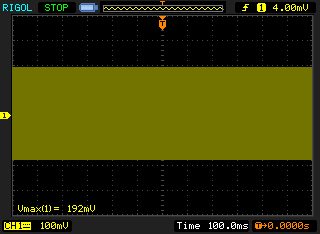

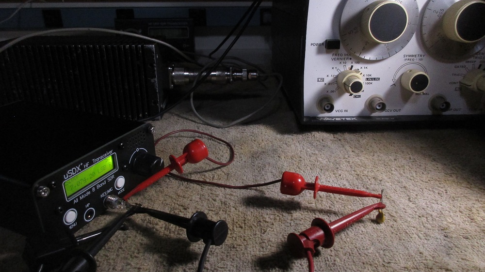

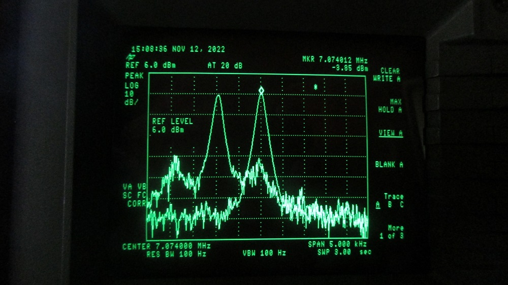

These are some SSB transmission tests. The test set up is either the uSDR or uSDX+ is connected to a Wavetek function generator as the audio source. The Wavetek is connected via a 10 ufd tantalum capacitor ( removes the +5 volt supplied by the uSDX+ to the electret microphone normally used ) to a 3.5 mm TRS connector attached to the uSDX+. Transmit occurs when a jumper shorts the sleeve of the TRS connector to the ring. The Wavetek modulation frequency is 1 kHz.
This is an image of the output of the uSDR+ to a digital scope with its input terminated in 50 ohms via 40 dB attenuator. 196 mVp is about 3.84 watts at the input to the 40 dB attenuator in CW mode.
This is an image of the output of the uSDR+ in LSB mode on 40M with the audio level adjusted for the same output power as in CW mode.

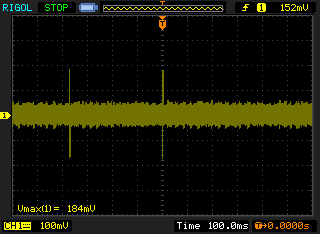

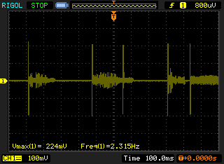

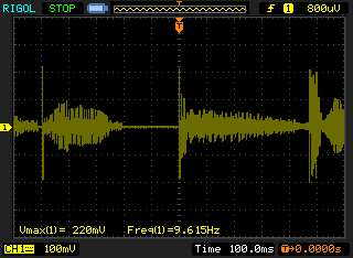

As the audio level is reduced, the RF output drops as expected but with some noise.

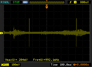

As the audio level is reduced more, the unit begins to transmit random full power pulses.

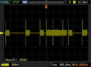

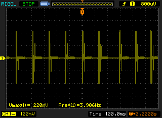

It gets worse as audio level is reduced again.
When there is no audio drive at all, the pulses do not occur. The above images were all taken with Noise Gate = 4. Below is the same audio level as before except the Noise Gate = 0. For the audio level shown, it was found that a Noise Gate level of <4 ( in other words Noise Gate = 0,1,2, or 3 ) eliminated the pulses. As the audio level was reduced further, the Noise Gate value also had to be reduced to prevent the pulses. Since the human voice has a large dynamic range, it is not clear why the Noise Gate would ever be set to other than 0.
This might not be true for digital modes which use audio tones of constant amplitude in which case a Noise Gate value higher than 0 would still work.
The above addresses SSB issues in the time domain. Now let’s have a look in the frequency domain. The test set up is the same as above but an HP8593E is used to view the output of the uSDX+ through a 40 dB attenuator.
The signal in the center of the screen is the uSDX+ in CW mode. The signal to the left of it is the 1 kHz LSB signal. The important difference is the the LSB signal has a considerable noise floor which is many kHz wide.
For comparison, this is the Icom 705 under the similar conditions.

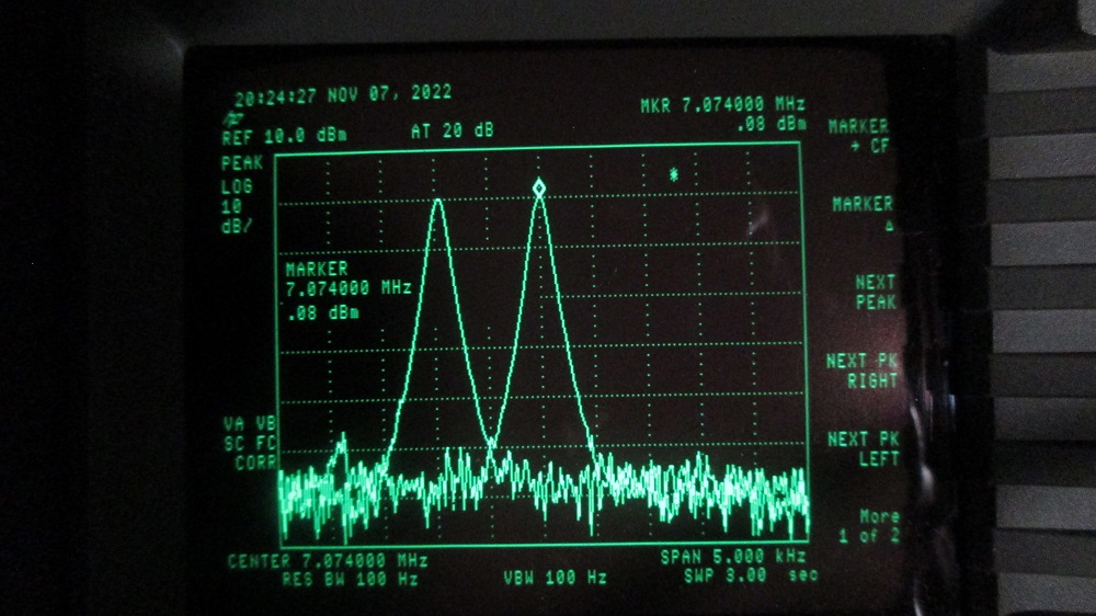

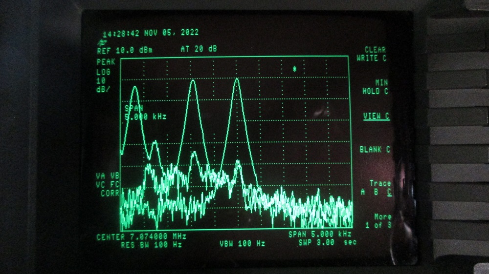

The transmit bandwidth of the uSDX+ and uSDR were both measured. The HP8593E is used to capture three traces. At the center is the CW signal, 1 kHz below is the LSB, then the Wavetek function generator is moved to determine the 3 dB bandwidth relative to the amplitude of the 1 kHz LSB. Below, the upper 3 dB bandwidth appears to be about 2.2 kHz from the CW carrier.
The lower 3 dB bandwidth is about 350 Hz from the CW carrier.
The transmit bandwidth is about 2,200 – 350 Hz = 1850 Hz. This is a bit on the narrow side compared to most SSB rigs with 2.1-2.4 kHz being fairly typical.

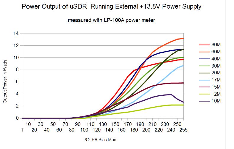

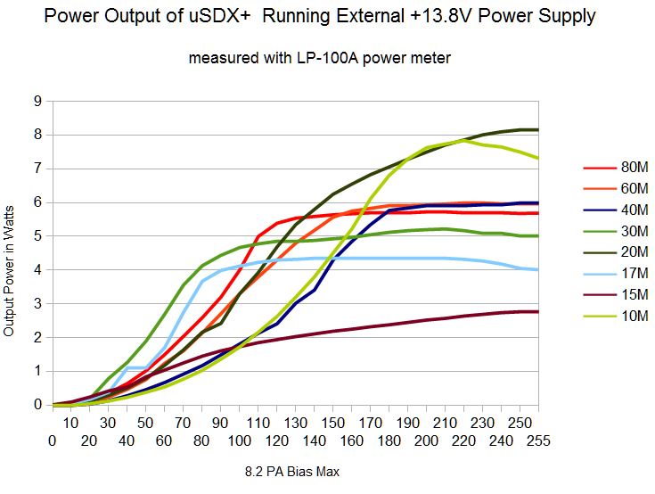

These are curves of output power for the uSDX+ with an external +13.8 volt power supply.

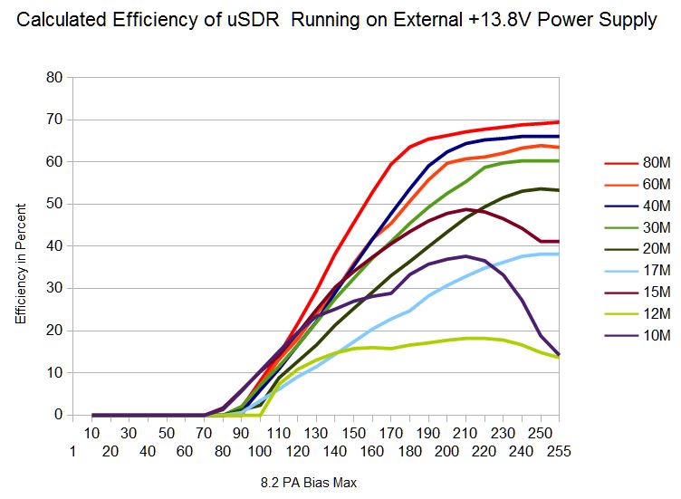

These are efficiency curves calculated from the current drawn during the above tests. The efficiency is calculated from the RF output measured with the current drawn from the +13.8 volt power supply with a correction. For PA Bias max = 0, the RF output is always zero measured on the LP-100A power meter but for 15M where it measured .01 watt. The current for each band at PA Bias max = 0 is subtracted from the total current to arrive at the current for the PA amplifier.
The efficiency is not a constant, varying considerably from band to band and from the PA Bias max used.

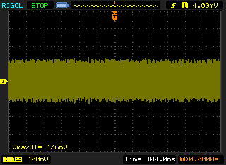

Below, PTT mode, Vol = 6, Noise Gate = 0

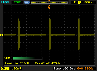

Below, PTT mode, Vol =6, Noise Gate = 9
These are images for the uSDX+ with it’s speaker/mic,
Vol = 0, Noise Gate = 0, VOX = on
Vol = 0, Noise Gate = 4, VOX = on
Vol = 0, Noise Gate = 9, VOX = on. For some reason at Noise Gate = 9 the pulses diminished with VOX where with PTT is was much worse.
Vol = 0, Noise Gate =9, VOX = on, same as above with voice added
Vol = 6, Noise Gate = 9, VOX = on. Raising the Vol from 0 to 6 brought this but there was a vast improvement in the last image if the volume was backed down to 5.

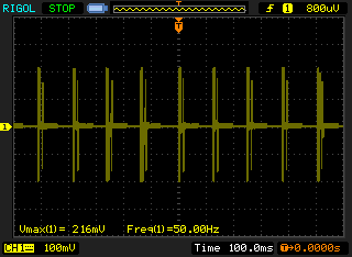

It does not require a scope to see these full power pulses during receive. They can be heard in the speaker/mic sounding like ignition noise. The developers may be aware of this problem with pulses on transmit. The attached note is embedded in firmware version 1.02x. I suspect they cannot develop VOX further or solve the pulse problem because they have run out of program memory space.
It looks like for the cleanest SSB audio at this time, it is best to avoid VOX; use PTT with Noise Gate = 0.
