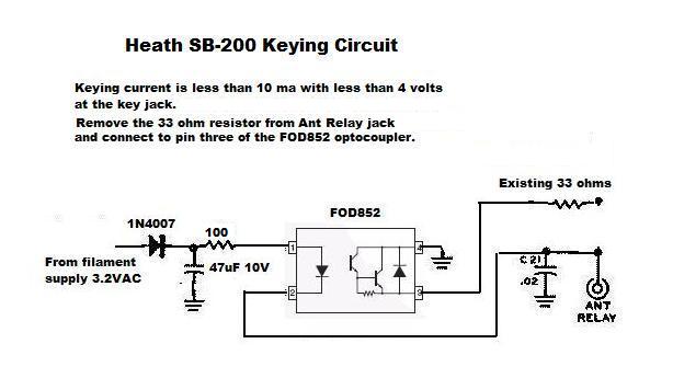

Jim, Do u have a link and/or schematic for that opto circuit? I bought a couple opto's just for this purpose but haven't got around to building it yet. I'll need to switch an old Henry which has a high voltage spike when it disengages. I did build one with a HV switching transistor and with the help of Phil but wanted to experiment with the opto.
Bob. W4JFA

« Reply #20 on: November 15, 2022, 05:46:01 PM »
I put this circuit in an SB-200 and it worked very well.
Re: How to determine if a buffer relay really is necessary from radio to amp?
« Reply #21 on: November 16, 2022, 05:40:54 AM »
Mine is basically wired the same way, except I didn't use a 33 ohm resistor.
Make sure you wire a rvs connected diode across the coil in the TR relay in the amplifier.
