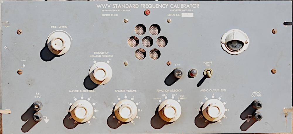

I need a schematic for Browning RH-10 WWV Standard Frequency Calibrator, circa late 1940's?
I rescued this from a scrap heap and would like to bring it back to life, but I have little experience with radio electronics. I've searched online and can't find much at all about this radio.
A member of antiqueradios.com did send me rh-10 a listing in the frederic research manuals of military equipment test equipment data handbook (volume-2), but sadly that does not include a schematic or alignment procedure.
Can anyone here send me a copy or tell me where to buy a copy of the schematic and/or alignment procedure for this radio?

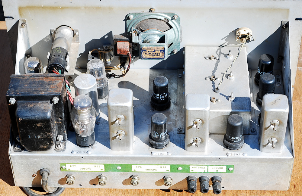

My model does not have a crt. Unless maybe the description is referring to the magic eye tube? I have worked on old Tektronix oscilloscopes so no worry about the deadly voltages present.
It would be a lot easier to work on it with a schematic... could someone help me locate one?

I have this working partly. A Ham in another forum provided me with the schematic for an RMA Dummy antenna hook up that allows me to match the output impedance of my Eico 324 to the antenna input of this RH-10 WWV boat anchor. With that setup the radio does tune to and detect the modulated 10Mhz signal from my Eico. So far so good.
However, I don't know the best way to convert the 50 ohm impedance of my antenna coax to what's needed for this RH-10. I have tried adapting via one of those 75-to-300 ohm converters made for TV's, but no signal appears to get through. Partly the problem is that my regular antenna at this particular location (which is pretty noisy) does not receive WWV very well to begin with.
So... what impedance does this RH-10 expect at it's antenna terminals? I am hoping not to have to need to make a custom antenna just for this purpose, but even if I decided to do that I still need to know what this radio expects at its antenna terminals for _best_ reception. Can someone enlighten me on that?
