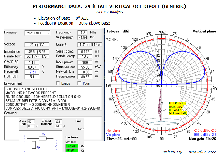

Here is what I think is going on.
Problem(s)
1) The Tuner Genius limited 10:1 SWR tuning range is preventing it from tuning the antenna on the 40 and 30 meter bands. My simulated SWR at the shack is 20:1 on the 40 meter band and 13:1 on the 30 meter band.
2) The length of coax -- even if RG-8X type -- is burning up a majority of your signal on some bands, hence the surprisingly low noise level and why it does not seem to get out. Even the tallest Greyline vertical [dipole] is only 28' and below the 20 meter band a remote tuner is a must to minimize feedline loss. An EZNEC model of the 28' vertical [dipole] fed thru 50' of RG-8 coax shows this coax loss:
80m,  20 dB (1% of your signal is making it thru the coax)
40m,  10 dB (10% of your signal is making it thru the coax)
20m,    1 dB
10m,    3 dB
Doubling the coaxial cable length does not harm performance on 80/40 meters too much because the SWR in the added line length is quite a bit lower.
Solution: Place a remote antenna tuner at the antenna.
My similar experience is tuning a 34' (not 43') vertical both in the shack thru 100' of LM-400 coax and with a remote tuner at the antenna. Using a 10:1 SWR capable ATU -- IC-7300 in 10:1 tuning mode -- it would not tune on 80 meters. Tuning it with a manual tuner worked but coax loss took a toll on my signal. Switching to an MFJ-993BRT remote ATU at the antenna base turned the antenna from just useable to quite satisfactory. Receive noise levels were much higher due to the much lower coaxial cable loss.

Correction plus coax loss simulation using 45' of LMR-400.:
I meant to say RG-8, rather than RG-8X. RG-8 is used in the EZNEC simulations. Here are coaxial cable simulation results using 45' of LMR-400.
80m,  17 dB (2% of your signal is making it thru the coax)
40m,    9 dB (13% of your signal is making it thru the coax)
