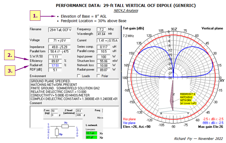

... An alternative to the OCF vertical dipole configuration is a vertical of the same height fed against earth GND and radials; changing things so the antenna is a continuous 28' fed against a 25 ohm GND.  The tuner sees a more manageable 30 -j530 ohms to match. EZNEC shows the OCF version providing 2 dB more signal.  ...
But observe that the OCF vertical shown in my Reply 3 neither needs nor uses a wired path to/through conductors buried in the (lossy) Earth in order to radiate about 90% of the Z-matched r-f power at its feedpoint terminals.  The radiation efficiency of that OCF dipole configuration is only 5% less than from an antenna system having zero loss!
That ~5% loss results from the ESRs of the radiator conductivity plus the the matching network at the feedpoint terminals, both of which are included in the values shown in Reply 3.
That is the reason why the OCF dipole has greater gain than a vertical monopole radiator using a series path through the lossy Earth, to enable r-f current to flow on the 'grounded' antenna system.

Thanks RFRY for the OCF info and let me run this by you. My EZNEC model (NEC-2) shows additional feed point resistance -- as well as decreased gain -- pointing to substantial GND loss when placed close to GND. The recommended installation is with the base 1' above GND.
Antenna: 28' long OCF, 3.5 MHz, modeled with Real GND, 0.005S/13.
Base height   Average Gain test  Real part of input Z
1'                 -11 dB                  16 ohms
2'                  -9 dB                   11 ohms
4'                  -8 dB                     8 ohms
8'                  -7 dB                     6 ohms
16'                -6 dB                     4 ohms
Free-space      0 dB                     2 ohms
A near-field radiation efficiency calculation using the free-space input resistance and the near-GND input resistances show near-field radiation efficiency approximating the EZNEC Average Gain test. For example, at 1' the near-field radiation efficiency is 12.5% which is loss of 9 dB.
RE = (2 ohms/16 ohms) x 100% = 12.5%
We are comparing different antenna systems here.  Below is a re-post of the one I included in Reply 3 of this thread.
The numbers now showing on the graphic apply to the text entries in the numbers listed below.
  • The base of my OCF dipole is elevated 8" AGL.
  • The "Efficiency" is the percentage of the Z-matched r-f power output generated by the tx PA that is present across the antenna feedpoint terminals.
  • The far-field-only "Radiat-eff." value is not a measure of the radiation efficiency of the antenna system itself, because NEC is not accurately considering the complete radiated wave when the (NEC-defined) "near-field" analysis is excluded from the calculation.
