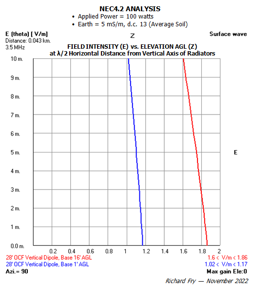

Below is a more direct, NEC4.2 comparison of the performance of the 3.5MHz OCF radiator that KH6AQ has posted here, for 1-ft and 16-ft base elevations AGL (other things equal).
The gain difference due to the elevation change for the conditions shown there is about 4 dB at zero degrees elevation.
NOTE: A calculation using only the NEC "far-field" values shows zero gains/fields in the horizontal plane at all distances from the radiator.
