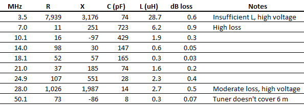

3.5 mhz, R=7938.71 ohms, X= +3175.87  ohms
7 mhz, R=11.43 ohms, X= -250.71 ohms
10.1 mhz, R= 16.28 ohms, X= -97.43 ohms
14 mhz, R= 98.34 ohms, X= +30.13 ohms
18.068 mhz, R= 52 ohms, X= +56.57 ohms
21 mhz, R= 37.44 ohms, +184.67 ohms
24.89 mhz, R= 106.99 ohms, X= +551.38 ohms
28 mhz, R= 1025.91 ohms, X= +1986.96 ohms
50.1 mhz, R= 73.34 ohms, X= -86.45 ohms
I did not run a test on 160
The values are charted across each band, so the above values represent one frequency....the start of eaxh band segment.
The plot includes, SWR, Z, R, X, Return loss and Phase angle.
Includes Smith chart for Impedence and S11
The analyzer, MFJ-226, was connected directly to the antenna twin lead, as designed (OCF).

Tim,
Based on your measurements, here are my observations:
The L and C values in the chart are the component values needed to match the impedance to 50 ohms in the low pass L match configuration used in your tuner.
  • On 80 meters the tuner does not have sufficient range. It is also possible to damage it due to high voltage
  • On 40 meters, the loss within the tuner could be sufficient so as to cause damage due to excessive heat. This is difficult to pinpoint due to actual inductor Q. For this chart, I estimated the inductor Q to be 100
  • On 10 meters, there is also the danger of high voltage and it has moderate loss
  • The tuner is not rated for 6 meters
  • The tuner should provide a reasonable match on the other bands although it may not be an SWR of 1
I suspect that if you put your 1:1 balun on the output of the tuner that it would find a reasonable match except on those bands with an indicated note. I would also recommend a common mode choke / 1:1 current balun on the coax before it enters the shack.
You may find some better results by varying the length or type of the feedline between the tuner and the antenna as this will change the impedance transformation that you are seeing.
« Last Edit: December 19, 2022, 05:33:13 AM by W9IQ »

Thanks for your analysis...
Yeah, after I saw the data.....I could see that 80 and 10....was probably a no-go...which is why I did not even try to test 160......I didn't conclude that 40....could cause a problem....but I did see that the SWR would not come down....
I tested 6....only because the antenna was supposed to work on 6......
So, basically....the low bands were my desire....in the first place....and it is useless on those frequencies...Looks like I have an extremely expensive Flagpole...
Do you think my results are caused by something in my installation?
Or, will this design ever meet the manufacturers claims...
So, what do you think the results would be if I modify the antenna to a standard vertical with ground plain?
Recall...I moved the 1:1 Choke Balun to the antenna side of the tuner before this test....results were so---so....
