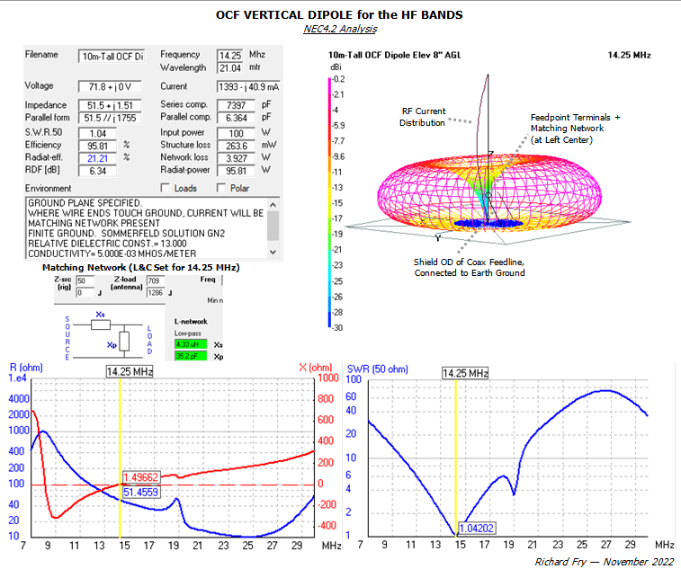

There are four places where power is commonly lost.  Typically the feedline, antenna tuner, nearby ground, and the antenna. ... Verticals often have high ground losses unless a good radial system is installed. ...
Below for consideration is an example of a 10-meter tall, multiband HF, vertical, OCF antenna system elevated 8" AGL, capable of good gain/radiation efficiency, low SWR(50) across a given band, and low loss on the feedline.
The elevation of the feedpoint is about 1.8 meters AGL, and the feedline shield OD is grounded about 1 meter from the vertical plane of the dipole.  No common mode chokes are needed or used.
