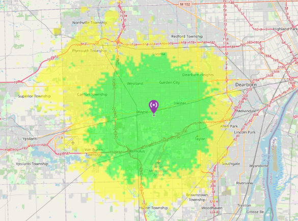

There are some tools that can help to estimate coverage. But since you have an existing station, it is good to compare the results of these tools to your current experiences. Here is 2 meter a coverage map of from your QTH at an elevation of 18 feet with a 3 dBi antenna talking to a repeater with an antenna 100 feet in the air. Does this look close to your current experience?

Thanks, Glen, for the map. It shows about a 15 mile radius. I can pick up repeaters out to 20 or 25 miles, they must be higher up. The coax is RG8U from Alpha in Florida, made in USA.
