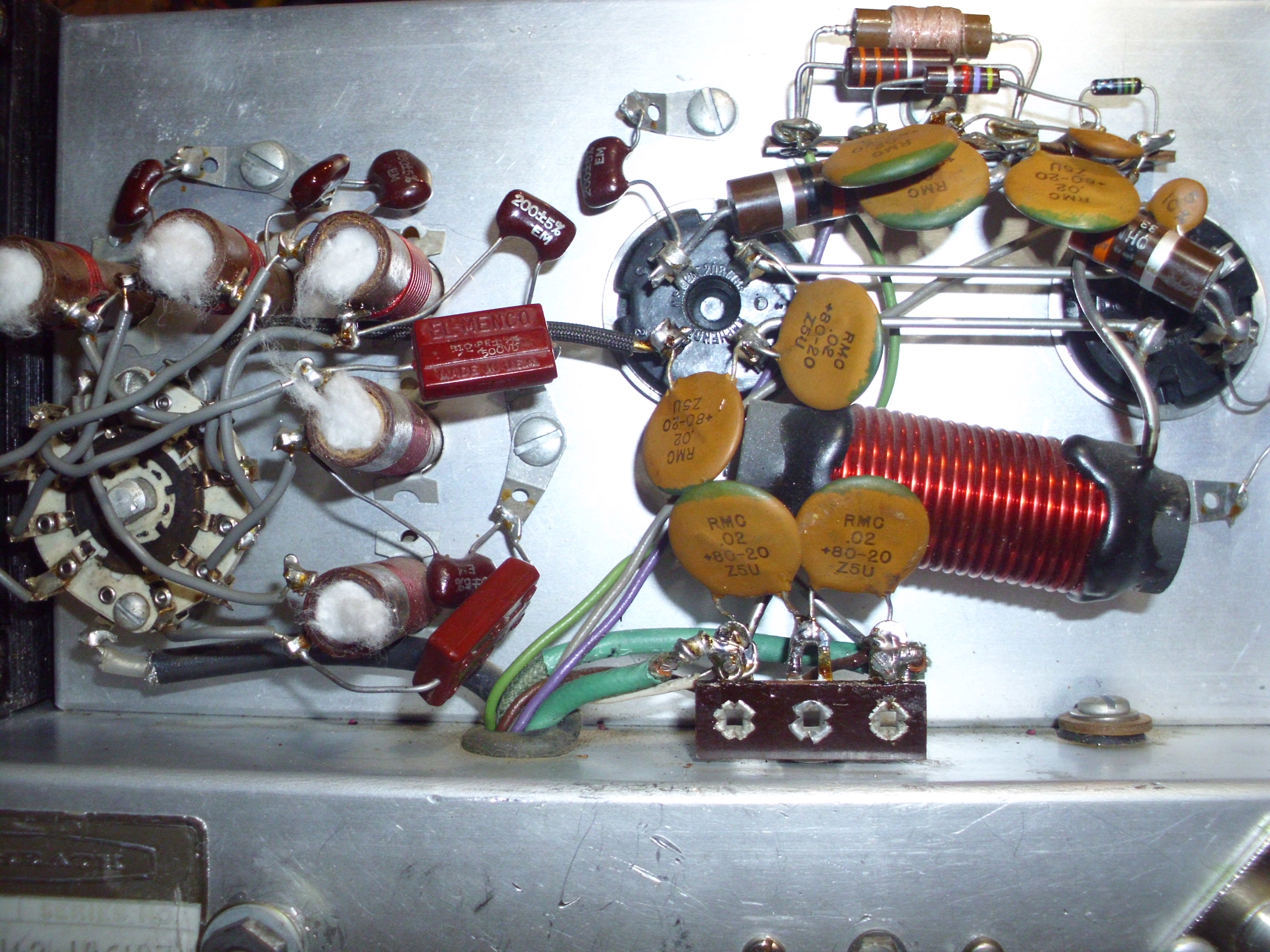

The bad
Band switch. What cleans up these, please? Would it be worth it in the long to get to Scubbin down? Switch contact cleaner? Or should I not worry about the tarnish/bluing and not mess around because it's so old. Or jus us DE-Oxit and be done?
I've not run the unit since the new P/S rebuild (new to me scenario). and checking everything and dotting my eyes and crossing my T's. BTW the band switch wafers have turned to a *Purple color. The camera does not show that Thanks 73 https://www.qsl.net/kd7tww/SB200/DSCI0211.JPG

Put some deoxit on a Q-tip and just wipe the contacts, exercise the switch several times, then wet with water another q-tip and wipe the contacts, use a heat gun or hair dryer to expedite the drying. Using the 572's in a rig is probably the best way to test them. My original 572's have been in my SB-200 since it was built in 1969.

Silver plated switch contacts oxidise, it’s normal. Even “new” switches that have been in storage discolour over time.
Use a non residue switch cleaner, rotate the switch and it will clean. Don’t be tempted to use switch cleaner which contains oil, yes it minimises future oxidation, but dust accumulates on it making a real mess.
Your amp looks to be very clean, I had an SB200 several years ago, nice amp if a little sluggish on c/o.

You can test a 572B in any tube tester that will test an 811.  Just use the 811 settings.  Most emission type tube testers won't do a gas test, though.
To test for gas, look for color in-between the elements of the tube when it is energized with HV in the amplifier.
Color at the interior surface of the glass is OK (actually indicates a hard vaccuum).

A Hickok 600 can do a gas test.  It's better to discard a gassy tube
before plugging it into the SB-200 for a 'trial by fire'..
The Hickok gas test is based on adding or removing
a high-value resistor in series with the control grid
while monitoring plate current. This is a push-button test
with the Hickok.
A tube with acceptable gas will not have much of a shift
in plate current due to the presence or absence of the added resistor.
Hickok says less than a one-division increase on the transconductance
scale means the tube passed.
