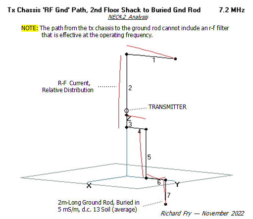

« Reply #13 on: December 08, 2022, 01:40:06 AM »
11 replies and only one correct answer. the answer is simple, follow electrical codes and best practices. Bond you coax to the same ground your AC service uses. You do not have a choice.
However that choice can result in an efficient and maybe unsuspected, radiating part of an antenna system (see below).
