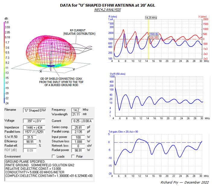

Re: EFHW 80-10M Configuration
« Reply #9 on: December 07, 2022, 04:32:38 AM »
... If I made an inverted "L", and I put bends in the L, will that cause an issue or limit the antenna in any way?
Example: Transformer and feed-point will start at 5' off the ground, (etc) ... Thank you again for any insight and help.
Below is a NEC4.2 study of what the performance of the antenna system will be for the conditions shown there — which are based on your OP.
The load match for a 50 Ω coax feedline connected to the EFHW input transformer will depend on how closely the transformer can match the R and j(X) impedances to the coax, across the various bands in the top graph at the right-hand side of the graphic.
EFHW antenna configurations may have higher peak gain(s), but more lobes in their radiation patterns on the higher bands than on the lower bands.
