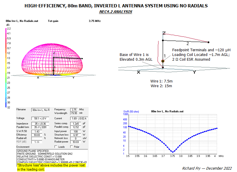

You also might be interested in some form of the 80m, inverted L antenna system concept outlined below — which needs/uses NO radials of any kind, might fit on a small lot, has high radiation efficiency, and useful radiation patterns.
73, and Happy Christmas to you.
Richard Fry, W9XMT
