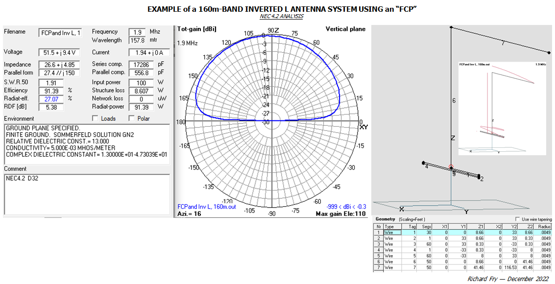

« Reply #17 on: December 24, 2022, 02:36:12 AM »
Below as a possible resource here is a graphic of a ~self-resonant inverted L using an FCP, that I put together from the outputs of a NEC study I did several years ago:
