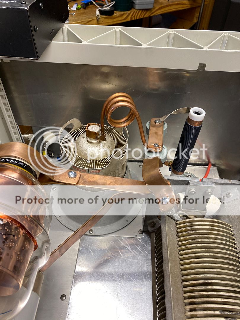

 I built a YC156A amp a couple of years ago.  I used a WD7S control board.
The power supply is 6000 volts DC more or less.
Anyhow, when the amp finishes the warm up period the grid current with 100 watts drive doesn't even light one LED.  But, if I get long winded on some story or something the grid current creeps up and may hit 100 mA.  To the point it was going in to soft fault on voice peaks with maybe a 2 second reset.
So, I just lifted the legs on the comparator associated with grid trip. Cured that problem.
I mean it has 15 dB gain. The output doesn't change. Tube hasn't blown up.  And, I'm certainly not going to unbolt everything until it does.
The tube doesn't show hot on the anode, if that means anything.
Just curious what the theory is here.

I have two Fluke 87's and I compared them to confirm they were somewhat accurate.
I took a bench power supply and put 100 mA on the lead that reads the grid current off the B- and set the LED meter to reflect that 100 mA.
I doubt the tank circuit is heating up, but a blocking cap may well be changing value.
https://hosting.photobucket.com/images/ah308/rgerringer/IMG_0236.JPG
« Last Edit: December 25, 2022, 04:41:01 AM by KM4AH »
Re: Question for some of you smart hams
« Reply #7 on: December 25, 2022, 05:41:35 AM »
Value of the block cap assy is not critical. If one of em shorted, it would take out the B+ supply via the safety choke.
That plate choke looks like an eagle made unit. Buddy uses the same one on a 4x10.  Runs stone cold on 75m.  Superb design.

Sort of gets back to it likely being the tube.  Some more evidence. When I first started tuning the amp in to a dummy load I got up to about 4000 watts out, then the wattage started dropping off and the input SWR went up.  So, I thought I had lost a relay on the tuned input board and replaced the 75 meter relay.
But, that was not the problem.
When I replaced the plate transformer and was re-tuning, same thing.  Wattage drops off, input SWR goes up and if you keep messing with it it will trip the 30 amp switch/breaker.
Soon as it cools back off it's fine.  So, there you go.
Something is breaking down when it gets hot.  The tube anode is never hot according to a laser thermometer.
It is really not an issue rag chewing SSB, and I really don't want to change that tube.
But, it would nice to know as close as possible what is causing it.

Local buddy built his YC-156 amp years ago (80-10m),   I sold him my old 6700 vdc supply (10 kva, 120 lb, 4800 vac, pole pig).   He bought a total of 12 (TWELVE ) YC-156's.....and only 3 of em are good   The other 9 were all duds...and all the 9 duds developed  (I think) a grid to cathode short...after aprx 5 mins into the 8 min warm up.  Of the 3 that work, 2 are superb, and the 3rd is down a bit on emission.   A good tube will do an easy 5 kw out with 100w of drive. 7 kw with 150w of drive..and 9 kw with 200w of drive.
You need a spare, good tube to verify the amp.   I would suspect the tube.   I can't recommend the yc-156 anymore, since the tubes on the market these days, are typ pulls of pulls.  Yrs ago, the 11m ops got a hold of em, and beat the crap out of them.
Contact Jim Klein,  K7RDX, as he has a source for good 156's / 172's.

I didn't see this issue before but a changing input VSWR maybe caused by increasing grid current, as grid bars expand and can rotate ever so slightly with temperature as they start grabbing electrons when not aligned properly over the stripes between cathode segments.
K1FO found reducing heater voltage about 10% reduced grid current effects in some 3CX800A7's where Ic was unstable as the drive was applied.
Grids in 8877's are very short and do not normally change like that but the YC156/YC179 grids is a very long structure and less rigid as a result.

Thanks. That makes a whole lot of sense . The tube was given to me. And, I think it was given to him or part of a trade. So, who knows why it was taken out of service.
Like I say, it has about 15 dB gain and works fine in normal SSB operation. I expect it would puke if I did contests.
This control board was designed around a single 8877 .  So, I'm not sure what the upper limit of the grid trip adjustment is.  I had to change a cap to get the warm up timer up to 8 minutes.
