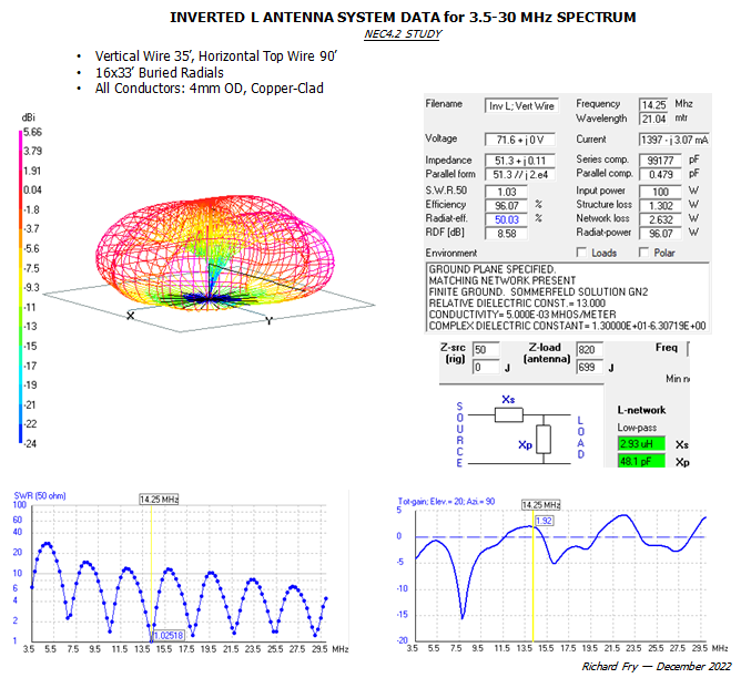

Re: EFHW vs. random length wire
« Reply #4 on: December 25, 2022, 07:47:11 AM »
Quote from: KD0VE
So - when or why would a random wire be preferred over a multi-band end fed?
The EFHW has to be a specific length, and only has a
low SWR on harmonics of the base (half-wave) frequency.
Some matching transformers appearing on the web can
have relatively high losses - up to 3 dB.
A random wire can be any length.  Too short and the
efficiency drops, but otherwise not particularly critical.
With either antenna, the radiation pattern on each band
depends on the length and arrangement of the wire.
With too long of a wire, the main lobes may be too narrow
for your operating preferences, although they can give
useful gain if they are pointing in the right directions.
If you want to use a wire on frequencies where it isn't
an integer multiple of 1/2 wavelength the high impedance
EFHW transformer won't work very well.  That's why your
40m antenna also works 20, 15, and 10m, but not 80m,
60m, 30m, 17m, or 12m.
The use of a transformer to match either sort of wire
is a relatively recent introduction.  There has been enough
recent work on high-impedance wideband transformers
that low-loss versions are possible if enough attention
is payed to the ferrite core and the number of turns for
an EFHW.
However, there no "appropriate" transformer that will
match a random wire across a wide frequency range,
especially one shorter than 1/4 wavelength.  The feedpoint
impedance can vary from less than 20m ohms (with
considerable reactance) for short wires to thousands
of ohms.  The standard 4 : 1 or 9 : 1 transformer will
lower the worst case SWR on bands where the wire is
more than about 3/8 wavelength, but will make it worse
on other bands.  G8JNJ has made a very extensive analysis
comparing various transformer types, which may be
worth reading for a better understanding.  Typical
losses are as low as 1 dB on some bands, and may
be 3 dB or more on others, even for the better choices.
Additional losses in the coax and tuner also need to
be considered.
There certainly may be times where the convenience
of a remote random end-fed wire overcomes the
potential losses.  For example, for a discrete antenna,
where you just set up whatever wire you can manage
and make it work across all bands of interest.  That
trade-off is a personal choice, there isn't any "right"
or "wrong" answer.
« Reply #9 on: December 26, 2022, 06:02:21 AM »
... I find myself wondering what advantage, if any, would arise from using a random length wire with the appropriate matching transformer.  ... thx in advance to anyone taking the time to share insight on the performance trade offs.
Below is a study based on the assumptions shown there, that may give you some insight into this.
Radiation patterns get a bit lumpy and unpredictable on the higher bands, but still might be quite useful in many directions.
