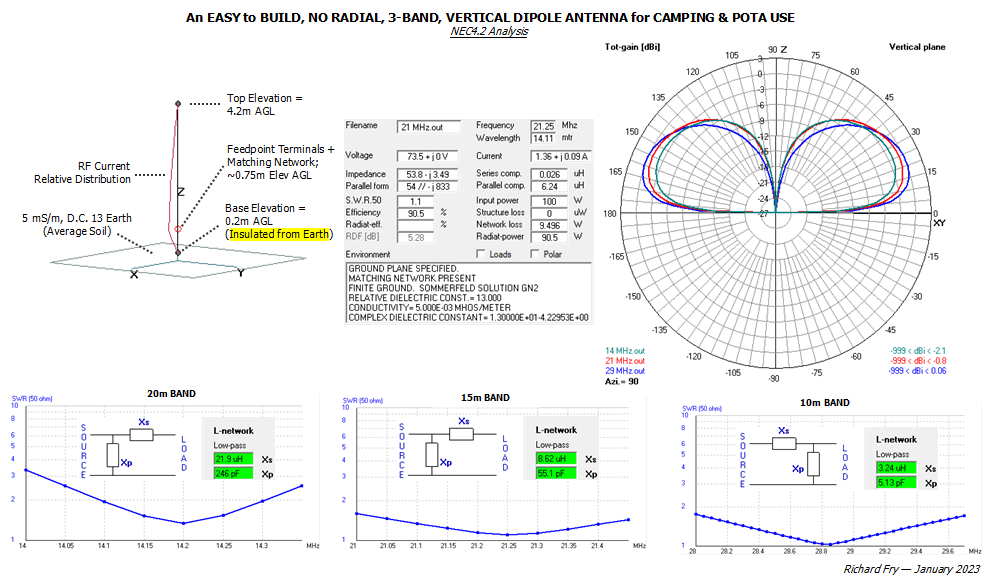

I have begun experimenting with elevated verticals.  I have found them to be easy to construct and surprisingly effective even with only 2 radials so I am working on an easy to deploy option for POTA and camping.  I know sloping elevated radials lowers the angle. ...  I'm thinking I can make a set up that will work on 10,15,and 20M with a relatively quick changeover.
Below is a description of a portable, 3-band, HF vertical antenna that needs/uses no radials. It might be worth building, experimenting with, and some real-world testing.
Its calculated performance is quite good, and it would be fairly easy to transport and set it up at an outdoor site.
