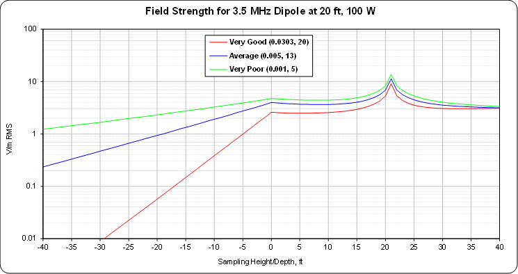

It's surprising how far the fields from an antenna penetrate ground in some cases. It varies with frequency and ground characteristics, but it can be tens of feet.
Here's something I don't think I've ever looked at before.  For a horizontal 3.5 MHz dipole at a height of 20 ft fed with 100 watts, this chart shows the above and below ground field strengths for three different ground characteristics.  The sampling point is offset by 1" from the center of the dipole wire.
Notice that a) the "below ground" field strengths fall off much more rapidly for good ground and b) the "above ground" field strengths also vary by ground quality up to about twice the dipole height.
Dan, AC6LA
