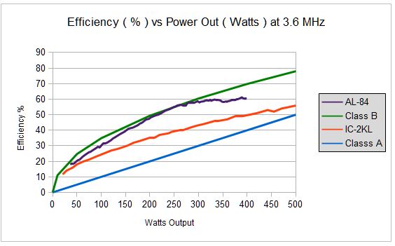

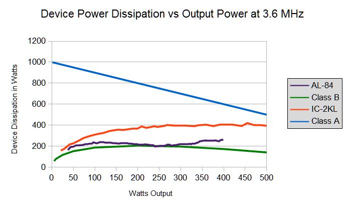

This data was taken earlier with a tube type Ameritron AL84 amplifier and an Icom 2KL solid state amplifier.
To show the change in power dissipated by the devices as a function of output power, the following was calculated.
Pd = Pdc - Prf, with eff ( efficiency ) = ( Prf/Pdc ) * 100
Pd = Prf * ( 100/eff -1 )
where Pd = power in the devices, Prf = output power, and Pdc = DC input power
Since class AB amplifiers are bounded by the theoretical class A and B curves, there seems little benefit to reducing power as a means to lower power dissipation in either tubes or transistors unless other means such as lowering the power supply voltage is used.

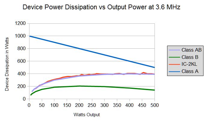

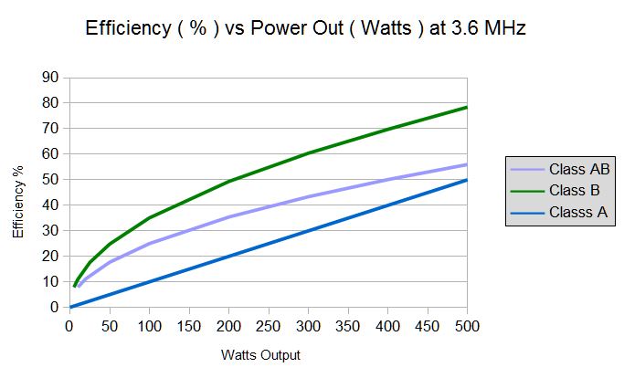

To calculate Solid State class AB amplifier efficiency at reduced power:
(PWRfull %) x (PWRreduced/PWRfull)0.5 = PWRreduced %
example
56% x (50W/100W)0.5 = 56% x 0.71 = 40%
Re: How amplifier device disspation changes with output power
« Reply #3 on: January 25, 2023, 09:15:49 AM »

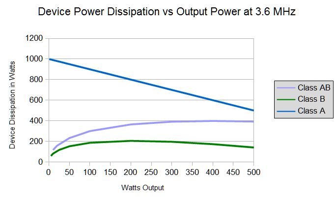

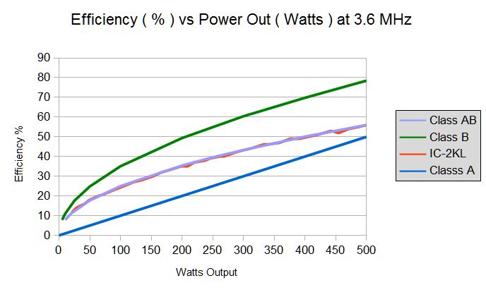

KH6AQ, I plotted your equation for efficiency of class AB to provide these three ideal curves for class A, AB, and B.
The measured efficiency of the Icom 2KL was plotted against ideal these curves. The fit was remarkably close.
These are theoretical curves for power dissipation vs. output power.
Added to the three theoretical curves is the calculated dissipation from the efficiency data for the Icom 2KL.
