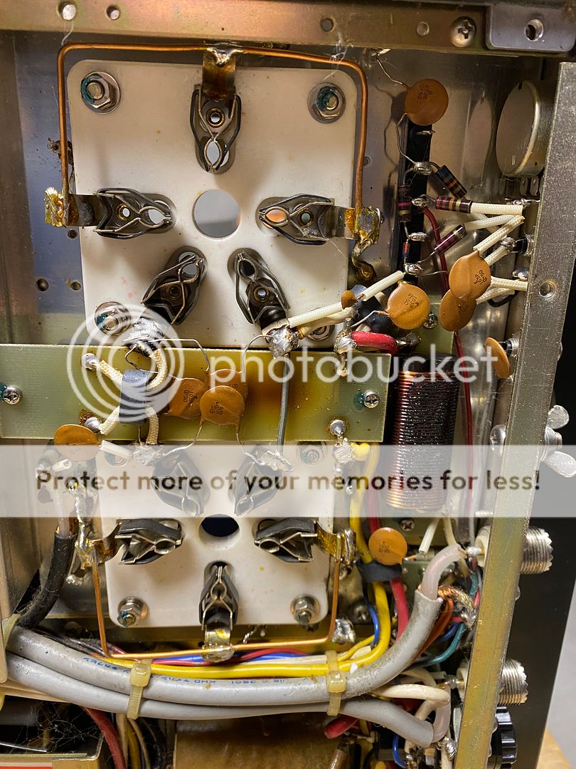

Friend brought me his this morning. Only one of the filaments working, turns out the solder was melted out of that pin. The other filament lit OK. Has HV. Pulls some idling current. But, absolutely nothing out. Zero.
He said the output dropped in half, and then went to nothing.
Anyhow, I ordered him a new set of tubes that should get here Feb 4.
I'm thinking I will be lucky if it is just the tubes.
Seems like I remember something about these amps not operating on one tube. Am I just remembering things ?

On the TL-922, the cathodes are in SERIES.  The CT of the 10 vac @ 15 amp fil xfmr is returned to the junction point of the cathodes via small ga wire, and a small choke. With one tube dead, or pulled out, the 15 amps now has to flow though that puny ga wire and choke.... which will destroy it.

Thought while I am waiting on tubes I would post this and maybe somebody would have an idea what cooked that choke. Thanks

I assume that's the bifilar choke ?  It's burnt cuz of either HV arcing the windings..or excess current.
On a another note, dumb question.   IF 2 x tubes have the cathodes wired in SERIES,  is the input Z now double as well ?
IE: each 3-500Z is aprx 100-110 ohms.  In parallel, the tuned input's are tweaked for 50 ohms.   Are they tweaked for 200-220 ohms when cathodes in series ??

The filament choke is hidden under the piece of polycarbonate. Much larger gauge wire. The burnt choke is in that filament circuit as well .
I have seen many videos of TL922's with all kinds of issues, but that choke did not appear to be discolored in any of them. Curious.
The owner doesn't know how to tune an amp any more than the man in the moon, and I think he was driving it with a TS950SDX at probably 150 watts . Even after he had lost one tube.

This is what I originally thought. The choke that is burnt up in the pix, is the extra (single winding) choke that's used for the B- return. ( It's wired between the junction of the series cathodes...then back to the  bias, cutoff bias, then to CT of fil xfmr).   The reason it burns up is simple. With either the filament gone open in either tube, OR either tube is UN-plugged,  the remaining good tube will still light up.  With 10 vac across the entire  secondary winding, their is still 5 vac between the CT and each outer end of fil xfmr sec.   You end up with 5 vac across the good tube.... BUT the return for one side of the good tube's cathode is now through that single winding choke...... which is obviously  not rated to handle 15 amps CCS.  (that  single winding choke that got zorched only has to handle cathode current, which is the sum of dc plate current + dc grid current, so maybe 800 ma + 300ma = 1100 ma).
That single winding choke being zorched, happens a LOT more than you think.  Hams have a problem with what they think is a grid to fil short on one of the tubes, so UN-plug one tube at a time to isolate the bad tube.  With one tube UN plugged, blamo, there goes the single winding choke.

The DC line for the filaments is in series.
The RF current on the cathodes is in relation to the grid.  Which is in parallel with each other.
Making the input impedance 110 / 55 ohms.

Thanks. I really don't know what to do with this amp. The fan delay is working. The plate voltage is around 3400 checked with a Fluke 87 and a HV probe. Filament voltage is good. Plate blocking cap is good. Coupling cap to the filament choke is good. Relay closes. Pulls idling current.
No output on any band.
I talked to AmpRepairGuy on the phone. I'm sure his price is fair, but the owner of this amp can't afford it.
Seems like all of the amp repair types that I might trust are too far to drive, especially when they are dead.
Anyhow, there is no signal passing through it for some reason.
I would think if it was the band switch it would at least work on some bands.

Well, after piddling with this some more, it is the band switch.  I can get a drop in replacement for a couple of hundred bucks off eBay. Man, I think I would rather have a root canal.

Good evening, actually it is the tuned input portion of the band switch, not the output. And, I have no idea. There is just no continuity on 40 or 80 meters. I can push it slightly, or turn it slightly, and get continuity. But, when in the detent position it's open.
Turns out the owner has never taken it off 75 meters since he bought it. So, I disconnected the output and input, put some heat shrink on the disconnected wires , and straight wired the 75/80 meter tuned input.
Works fine.  I'll put a note in there so that if some future owner wants to replace the tuned input portion of the band switch it should be simple but tedious.
