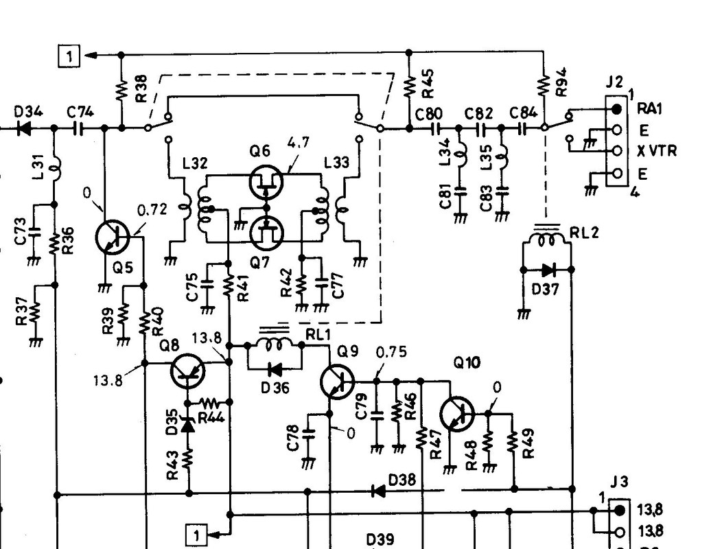

ICOM IC-740
PREAMP Circuit.
You can review this circuit on page 111 of the IC-740 Service Manual.
The function from my understanding is that : A) Preamp switch ON B) Switching BJT transistor Q9 switches from Cutoff
mode to full Saturation mode C) RLY1 picks, placing the Preamp inline D) Pre Amp composed of Q6,Q7 FETS increase the units
Sensitivity from 0.3 uV to 0.15 uV per specifications.

    When you push the Preamp button does RL-1 switch on? one side will pull to ground when the button is pushed.
    When the preamp button is on it connects Q9 emitter to ground, since the base is sitting at .75 volts, it's turned on and the relay is energized.
    The relay contacts are the most common mode of failure.
    You may find it's switching just fine but actually attenuating somewhat, that's the contacts.
    P.S. that switch contact no matter how noisy will never be heard in the receive audio the switch turns on a relay,
    the relay may have "noisy" contacts effecting the receive but not the switch!
    IT does not matter how crappy the switch contacts are as long as the switch is capable of pulling the emitter of Q9 to ground, if it can't do that then it needs replacing.DE AA7IS

Don't know if this is any help, but the same problem occurs on the 765 and it is a relay in the tuner unit.
Re: Icom Ic-740 Preamp Switch Noise
« Reply #9 on: January 17, 2023, 07:15:32 AM »
This is a known issue with relay contacts.  There are two common solutions.
One is to use gold plated contacts to eliminate oxidation.  This works as long as you don't hot switch the contacts with enough RF to burn off the gold.
The other is to run enough current though the relays to burn through the oxidation, typically around 10mA.
This is called wet switching.
https://www.edn.com/wet-and-dry-switching/
A relay designed for dry switching may fail if connected to an antenna that picks up too much RF from a nearby transmitter.
Another thing to consider when answering the question of how closely antennas can be located when connected to radios operating simultaneously.
