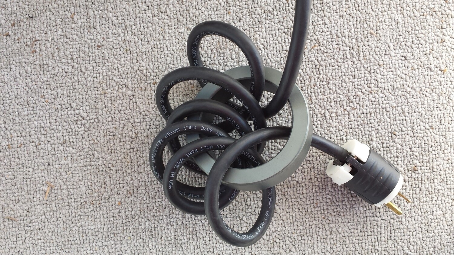

I recently purchased an earthquake IG800W generator. (800 watts peak). Its supposed to be a pure sine wave output.
The good news is i tested it with my old ts-520S into a dummy load, and it handles the 100 watts (all I will be running) with no issues. I assumed it would.
The bad news is when I hooked my rig up to my antenna to test out with a QSO, I noticeable hash/static...of approx S5-S6 on all bands and more on 160m
I suppose good news: When I left the generator running just outside my shack, which is relatively close to my antennas) but not used to power the rig, (I used house power), I had no noise at all...so the noise must be coming from the electric power out of the generator vs the motor/generator itself.
Any suggestions as to the best way to filter the power out of the generator, if thats an option.
I only paid $100 for it, and never used, and the purpose was for charging a battery, so if it wont work, no big deal...but if I can filter the power out for transceiver use, I'd like to have it as an emergency option.

See p. 23 of http://www.k9yc.com/RFI-Ham.pdf
A substantial common-mode choke, per the design described in Jim’s document, and possibly a commercial EMI filter (SAFELY enclosed and properly wired), are required. The alternative is to sell the beast and get a Honda 2000i, which is known to be RFI-free in almost all cases.

Well guess what? It is not Pure Sine Wave. If it were, you would not have the problem. What you have is a generator/inverter and now you are stuck having to use a ham Band-Aid to try to fix your mistake. Unfortunately, you will never eliminate the noise, you might be able to make it usable, but never eliminate it.
What you can try to do is make a common-mode noise filter using FT400-31 doughnut ring with as many ugly turns as possible with the AC line cord. Good luck.

Update
So after reading thru these answers / suggestions and being impatient.
I had a couple spare size 240 type 31 toroids. So I took a power cord, cut the female side and wound probably 15 turns on each and put them close to each other and probably 12” from where the male plugs into the generator
Added a female receptacle to the end I cut off. So basically a 10’ extension cord with the toroids right by where I plug into the generator.
First without the generator running I checked my noise floor on a few bands.
Then with the generator running and powering my kenwood t’s-520s, I checked the noise on the bands I checked before.
Good news. Noise floor was the same. For me, this time of day - 3:30 eastern (730 usc) …75m is around s6. 40m around s3 and 20m around s1.
With the generator powering my rig the readings were all the same whether powering off house power and no generator running or powering off the generator.
So for me, this solution seemed to work.

Just this last weekend I fired up a brand new non-inverter 4 kW generator for a portable 160 meter operation. Initially it produced S6 noise (3 kHz BW) on a 1/4 wavelength groundplane. Using items on hand we wrapped the line and neutral 10 times through two stacked F240-31 ferrite cores to form a CM choke. That knocked the noise down to S4. We then had three earth grounding options:
No earth ground
Earth ground to generator GND stud
Earth ground to the extension cord ground wire (CM choke output side)
