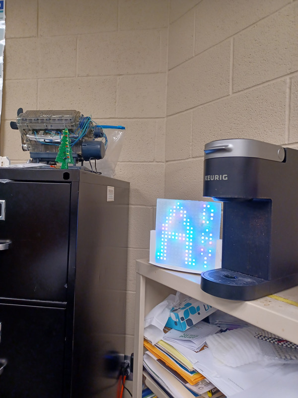

. . . and, on the note of the comment above and the fine bit of community it represents, I decided to just leave for a while.
I decided to take a bit of advice from the stoics and just do. With little more on that point. Here is the project in its near final prototype stage. The next step is to solder it up and 3d print the enclosures.
The "problem" to be solved is that the school I teach at has an alternating A/B day schedule. The students, and not a small number of the staff and faculty are frequently asking what day it is. I decided to make a sign that will be at the opposite end of the classroom. Yes, I have a simple paper sign that I have one of the students turn to the correct day. However, there is no task to simple to have complication created in its solution. I decided to make a remote controlled sign.
I will add that, having seen this, several teachers have asked for these in their classrooms. As long as the parts come out of their department budgets, it is great as it can give my students more fabrication practice. Keep in mind, these students are generally seventh and eighth graders who have never soldered, or handled electronic components, before coming to my class.
Here is the sign, it hasn't gone up on the wall yet because I was still playing with the code:
The LED Christmas tree on the file cabinet is an example of the current "learn to solder" projects
This is what it looked like without the glass and defuser. It is sort of funny, in pictures it looks almost the opposite as it does when looking at it in person, the bare panel is almost unreadable in person and the version with the defuser is much easier to read, besides, the defuser gave me a reason to get the art teacher involved.

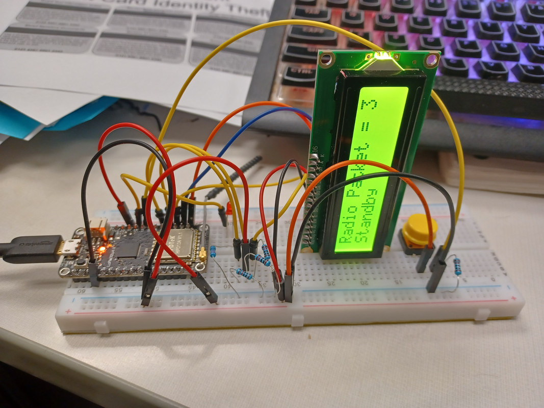

Here is the controller. The button cycles through the displays. Standby just lights a single LED so I can see that it is on, but isn't bright. After each button press it send the signal to the receivers ten times, then it stops transmitting and the LED goes off.
And, of course, the code. First the transmitter code. I am working on using interrupts instead of having the button detect in a function the way it is. However, these boards a still a bit new to me and I am still working that out.
. . . oops, it looks like that exceeds the allowable post length. I will put the code in the next two posts.

  // manual reset
  digitalWrite(RFM95_RST, LOW);
  delay(10);
  digitalWrite(RFM95_RST, HIGH);
  delay(10);
  while (!rf95.init()) {
    Serial.println("LoRa radio init failed");
    Serial.println("Uncomment '#define SERIAL_DEBUG' in RH_RF95.cpp for detailed debug info");
    while (1);
  Serial.println("LoRa radio init OK!");
  // Defaults after init are 434.0MHz, modulation GFSK_Rb250Fd250, +13dbM
  if (!rf95.setFrequency(RF95_FREQ)) {
    Serial.println("setFrequency failed");
    while (1);
  Serial.print("Set Freq to: "); Serial.println(RF95_FREQ);
  // Defaults after init are 434.0MHz, 13dBm, Bw = 125 kHz, Cr = 4/5, Sf = 128chips/symbol, CRC on
  // The default transmitter power is 13dBm, using PA_BOOST.
  // If you are using RFM95/96/97/98 modules which uses the PA_BOOST transmitter pin, then
  // you can set transmitter powers from 5 to 23 dBm:
  rf95.setTxPower(23, false);
int16_t packetnum = 0;  // packet counter, we increment per xmission
void loop()
  readTheButton(ledCount);
  unsigned long currentMillis = millis();
  if (currentMillis - previousMillis >= interval) {
    previousMillis = currentMillis;
    int radiopacket = 0;
    radiopacket = ledCount;
    lcdDisplay(radiopacket);
    TxButtonState = digitalRead(buttonPin);
    //  digitalRead(buttonPin);
    if (TxButtonState == HIGH) {
      TxCount = 0;
    if (TxCount < TxAttempts) {
      Serial.print("The TX Count is ");
      Serial.println(TxCount);
      itoa(packetnum++, radiopacket, radiopacket);
      Serial.print("Sending "); Serial.println(radiopacket);
      Serial.println("Sending...");
      digitalWrite(ledPin, HIGH);
      delay(10);
      rf95.send((uint8_t *)&radiopacket, sizeof(radiopacket));
      Serial.println("Waiting for packet to complete...");
      delay(10);
      rf95.waitPacketSent();
      // Now wait for a reply
      uint8_t buf[RH_RF95_MAX_MESSAGE_LEN];
      uint8_t len = sizeof(buf);
      Serial.println("Waiting for reply...");
      if (rf95.waitAvailableTimeout(1000))
        // Should be a reply message for us now
        if (rf95.recv(buf, &len))
          Serial.print("Got reply: ");
          Serial.println((char*)buf);
          Serial.print("RSSI: ");
          Serial.println(rf95.lastRssi(), DEC);
        else
          Serial.println("Receive failed");
      else
        Serial.println("No reply, is there a listener around?");
      digitalWrite(ledPin, LOW);
      TxCount++;
void lcdDisplay(int radiopacket) {
  if (lastPacket != radiopacket) {
    lcd.clear(); // clear the display
  lcd.setCursor(0, 0); // Character Position 0, Line 1
  lcd.print("Radio Packet = ");
  lcd.setCursor(15, 0);// Character Position 15, Line 1
  lcd.print(radiopacket);
  if (radiopacket == 1) {
    lcd.setCursor(0, 1);// Character Position 0, Line 2
    lcd.print("A Day");
  if (radiopacket == 2) {
    lcd.print("B Day");
  if (radiopacket == 3) {
    lcd.print("Standby");
  lastPacket = radiopacket;
void readTheButton (int theButtonValue) {
  // read the state of the switch into a local variable:
  int reading = digitalRead(buttonPin);
  // check to see if you just pressed the button
  // (i.e. the input went from LOW to HIGH), and you've waited long enough
  // since the last press to ignore any noise:
  // If the switch changed, due to noise or pressing:
  if (reading != lastButtonState) {
    // reset the debouncing timer
    lastDebounceTime = millis();
  if ((millis() - lastDebounceTime) > debounceDelay) {
    // whatever the reading is at, it's been there for longer than the debounce
    // delay, so take it as the actual current state:
    // if the button state has changed:
    if (reading != buttonState) {
      buttonState = reading;
      // only increment the LED count if the new button state is HIGH
      if (buttonState == HIGH) {
        ledCount++;
        if (ledCount > 3) {
          ledCount = 1;
  // save the reading. Next time through the loop, it'll be the lastButtonState:
  lastButtonState = reading;
  return ledCount;

And here is the receiver code. It includes some functions that define the images. The way it is written, it will be easy to add more images (Like MAPP test day, State Test day, KELPA test day, NAEP test day. . . you get the picture. . .)
http://#include <FastLED.h>
