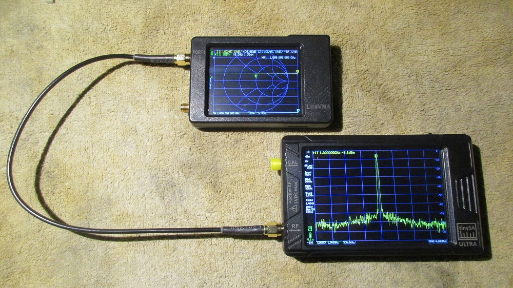

I had an original nanoVNA received as a gift in 2019. It was limited to 101 data points horizontally on its screen. For a spectrum analysis, I have an HP8593E covering 9 kHz-22 GHz. This TinySA Ultra came in a few days ago. I had upgraded to the LiteVNA last year with 1024 data points horizontally.
Now a 6.3 GHz VNA and 5.8 GHz SA can fit in pants pockets. Unlike the original TinySA with a 30 kHz minimum resolution bandwidth, the Ultra has a 200 Hz resolution bandwidth. With its earphone jack on the bottom, it can demodulate AM and FM ( using slope detection ).

Both the TinySA Ultra and LiteVNA which goes to 6.3 GHz are carried by R&L and Zennko. R&L currently has stock on the Ultra but out of stock on the LiteVNA. Zeenko has stock on both. If you like Deepelec, they stock the LiteVNA also.
Both can capture the screen to a microSD card which saves a lot of time if you like to document your work. The Ultra came with a 32 GB microSD card, the LiteVNA did not come with the card. Also, the Ultra allows saving the test set up and recovering the image to it's own screen. The LiteVNA cannot do that. LiteVNA images are viewed by removing the microSD card and viewing its contents on a computer.
