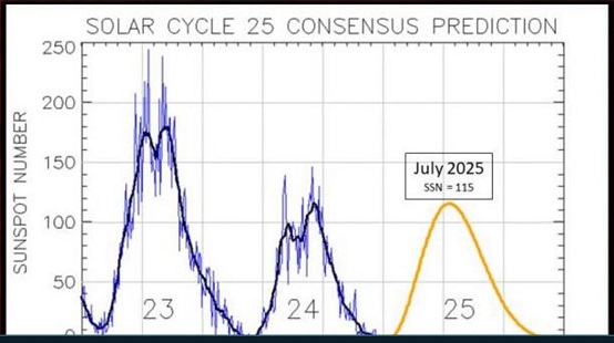

Cycle 25 has been looking good thus far, and if things keep progressing at this rate, we may see another Cycle 23 or better. I've had a good feeling about this cycle since 2020, even with this prediction...
What's that they're saying now? Exceeding expectations?
Well, exceeding expectations = OOPS, we must have gotten that one wrong.
I have respect for Dr. Hathaway, solar physicist for NASA. His knowledge of the sun has helped solve crimes. But I just don't believe anyone on earth can predict what the sun will do years from now, like meteorologists can predict what the weather will do a week from now. (And they can be wrong about that too)

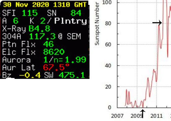

DXing / Re: Sun Spots!
« on: November 30, 2020, 05:55:10 AM »
It keeps getting better and better. SC 24 took about 2 years from takeoff to reach 80 SN. SC25 did it in 11 months! Of course we don't know how this will end up when SC25 peaks, but if it keeps up this pace, HOLY MOLY!

When I said, "But I just don't believe anyone on earth can predict what the sun will do years from now, like meteorologists can predict what the weather will do a week from now" maybe I was vague in the way I said it. What I meant is I don't believe solar scientists at NASA, nor any place else can predict solar weather years from now with the same degree of accuracy meteorologists can predict the weather here. (And that turns out wrong sometimes too)
As I recall, Dr. Hathaway and other scientists first predicted Cycle 24 would be a humdinger. As it started upward, they changed their minds and made predictions that pretty well came to be. This is the NOAA/NASA Prediction for Cycle 25 made in Dec 2019. I made my comments about a year later, based on how the cycle was progressing.
