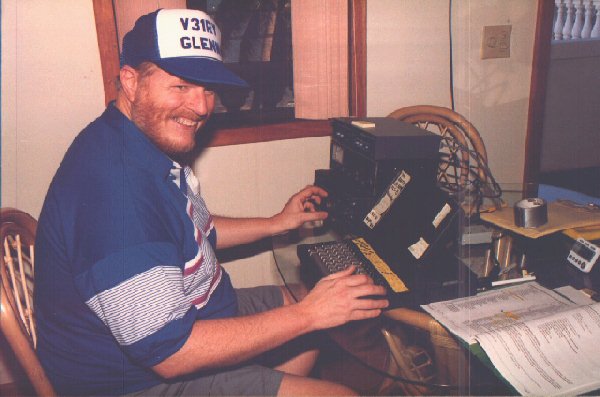

That's pretty funny :-)  Not QRP but in the 90's I went to Ambergris Caye, Belize three times for DXpeditions to activate V31 on RTTY, which at the time was very scarce on that mode.  I also operated CW contests on the weekends, my call there was V31RY  (RY, get it??) ..
Getting on the air on RTTY in 1992 meant a 386SX laptop, a terminal unit FSK demodulator, Icom switching power supply (the only one you could get then), backup antenna tuner and a TS-450SAT with 400Hz IF filter and connections to run FSK for days at 100w.  I got it all in a HUGE, heavy-duty nylon laptop case and a big PVC tube for the R-7 vertical and 26 ft collapsible aluminum mast to elevate the R-7 and support a 40m/80m dipole...
On one trip down there I was opening the bag for Belize Customs to inspect when another traveler saw the laptop and commented that when HE went on vacation, he left HIS computer at home !
