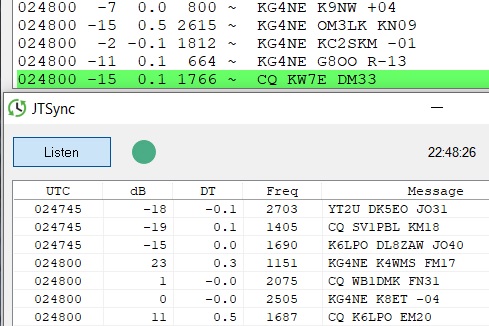

Downloaded JTSync, and it works fine for syncing my clock with NTP. But it doesn't track my decodes, it stays blank. Any suggestions?

« Reply #1 on: March 31, 2023, 06:31:04 PM »
It works if I click the listen button so the button turns blue.

« Reply #2 on: March 31, 2023, 06:37:07 PM »
I get an error when pushing the listen button...

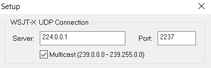

Thanks for the help, I've got it working now. After changing the server and port in JTAlert settings, had to do the same in JTSync setting, plus check the multicask box.
Now if I see a station I need with their clock out of sync, maybe I work them. Checked and I'm still reporting to PSK Reporter after making those changes.
