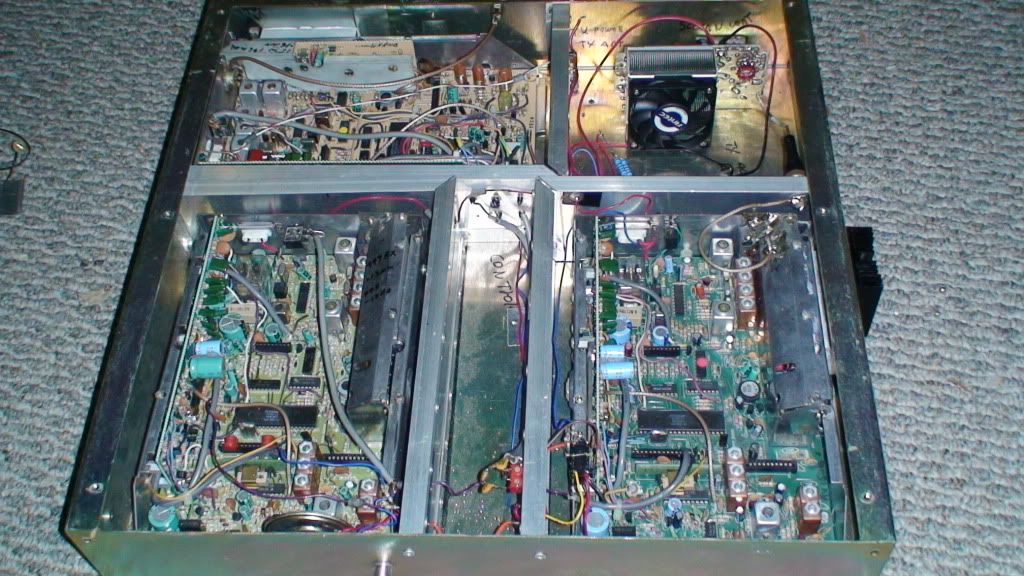

I put together 3 regency 10 channel programable radios as a temp uhf repeter with a simplex link to vhf.
It works off the squelch voltages and the ctcss tones to work the key ups.
Also by changing the sub tone input to the uhf  can change the vhf frequency by using the led driver voltage of the led driver on the rxing uhf unit.
output is 25 w uhf and 20w vhf
http://i631.photobucket.com/albums/uu39/dav850/DSC00183.jpg
