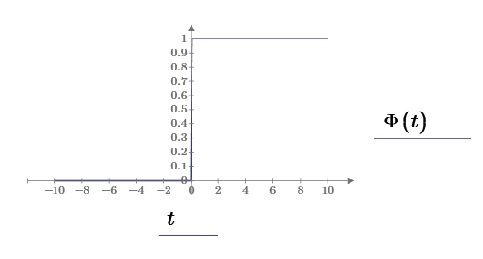

It seems incongruent to talk about the spectrum of just a click: a spectrum is a frequency domain thing and is taken over a long time on a signal that is often repetitive so it seems inappropriate to say things like 'here is how the spectrum decays over time' or 'here is the spectrum of the click'.  But in the sixties scientists and engineers realized there is meaning in these statements...signals packed with information vary over time and short-term spectra that change frequencies as the signal varies provide valuable information.  A field of study called harmonic analysis studies these time-shifting spectra and interesting transforms such as the short term Fourier integral and wavelet transforms are used as tools.
We model the click at the beginning of a code element with a unit step function, which goes instantly to one at time zero and stays at one forever.  Our code element eventually goes off so we will discuss how this changes the spectrum of the simple unit step model we are using.
Here is the unit step:
The Fourier integral transform is used to find the spectrum of the entire unit step.  Here is the Fourier integral that converts a time function in seconds to a frequency function in hertz:
We multiply the time waveform by the sine and cosine of the frequency we want, and integrate the results to find the magnitude and phase of that frequency component.  Note the infinities in the integral limits: we must integrate the time waveform over all time. But we can simplify:  times before zero are all zero so we can move the lower limit up (as long as we are not interested in really, really low frequencies) to near zero. As we move the upper limit to smaller and smaller times, we find the only thing affected is the energy at or very near zero Hz.  So the 'leftover' portion of the spectrum must be what is making the keyclick.  Here it is, plotted as amplitude magnitude versus frequency.
Plotted in dB:
I was surprised that the absolute magnitudes seemed so low, but all the energy in that waveform that gets through your receiver passband is packed into a very short time, so you will get a nice sounding click.  Note that the energy does drop the farther you go off frequency, and that the decay is continuous, as we observed.  When we modulate the carrier with this step, we get the click both above and below the carrier as we hear.  The spectrum at the end of the code segment is identical.
We can see that a low pass filter set to the right frequency will cut out most of this spectrum and that is what is used in the transmitter keyclick filter.
Anything that enhances the rising or falling edge slope will make the clicks worse.  For an amplifier, a really bad case of power supply sag, where the transmission starts out at very high power but quickly decays to a constant value due to droop in the DC supply could in theory enhance a transmission that already is close to having keyclicks.  The power supply droop caused by too-low capacitors in the DC supply would be too slow to make something as fast as a click, but poor (resistive and/or inductive) wiring from the DC supply to the finals might be able to do it.  So I think it may be possible for an amplifier alone to generate keyclicks in unusual cases.
