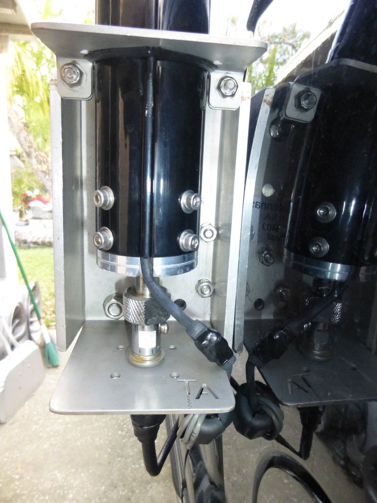

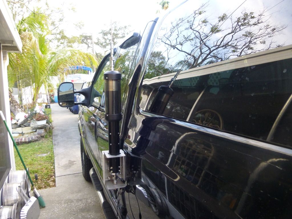

Here is what I am working with
Great swr on all bands...but on 40 messes with the truck....

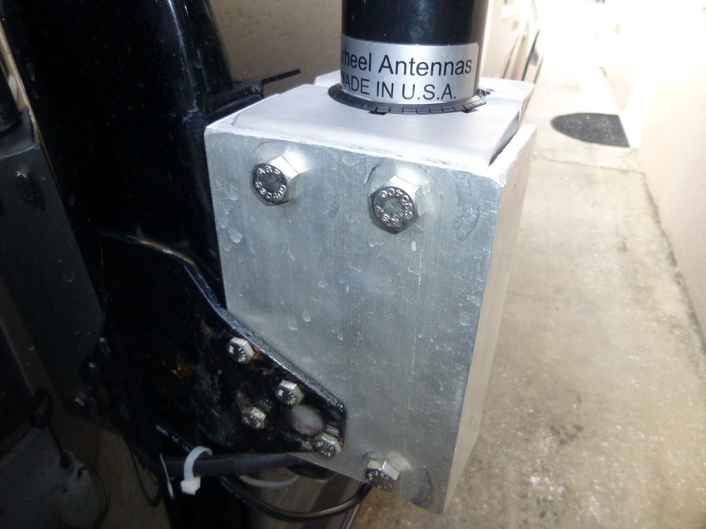

« Reply #6 on: March 08, 2017, 03:18:22 PM »
one more

Nice job but I would of placed it on passenger side. I did a bumper mount on my Suburban on drivers side on logic it would not hit limbs near edge of road but regretted it ever since. It hit every drive thru over hang when it is attached. Had I mounted it on other side it would not of been a issue.
Ham since 1969....  Old School 20wpm REAL Extra Class..
W4AKF
Posts: 17
« Reply #8 on: March 08, 2017, 04:08:12 PM »
my 144-440 is on the other side  lol.....no drive ins for me....but it does have the quick disconnect if I have to...
