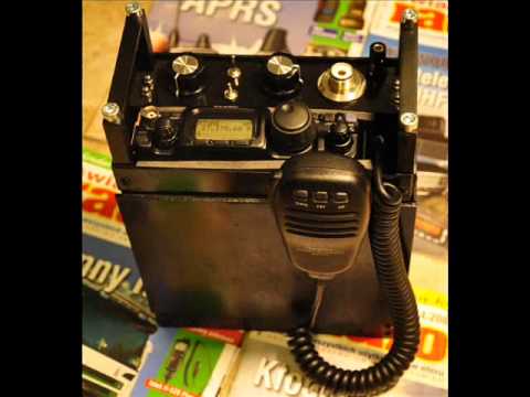

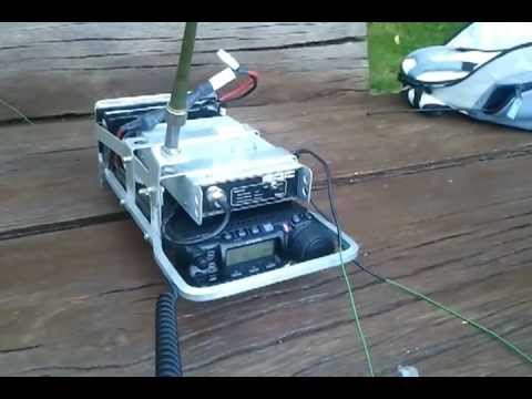

No one has to buy the VX 1210. One can build a manpack themselves and there are hams that have modified the FT-817, FT-857 and the FT-897 into "manpacks" with varying degrees of success.
Someone built a manpack out of the FT 817
Someone built a manpack out of the FT 897
Someone built a manpack out of the FT 857
Someone built a manpack out of the KX3
